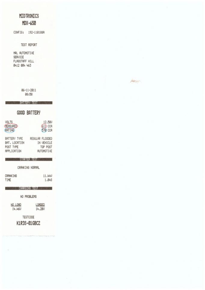

Maybe the times have changed, maybe it is that I use CTEK charger very often , but the battery in my T5 is around 5 years old and is still in top condition as my newly purchased MIDTRONICS MDX650 tester says. I also tested still original battery in our Golf5 TDI and here is the result of the morning test.
Battery was regularly charged (once a month) with CTEK charger.
