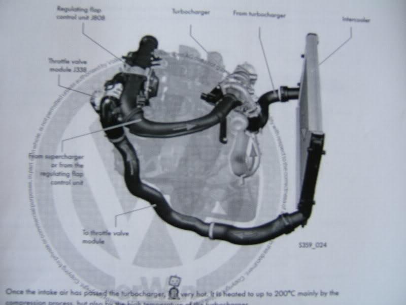

                Sorry mate, only the 1.9 has a tiny sidemount. The golfs and jetta's etc have a radiator sized one, in front of the radiator, behind the AC core. From my tests it's amazingly efficient too.
                eg the "baby" TSI dual charge:
