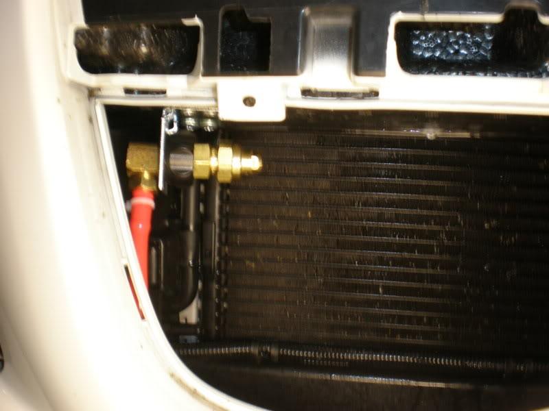

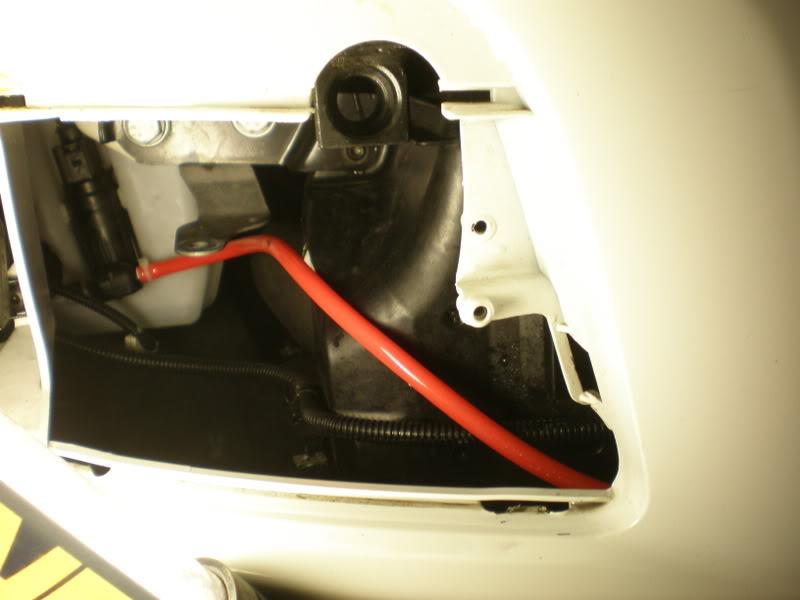

    I hooked up the right side outlet of the window washer pump (when facing the front of the car) that goes to the rear window sprayer, to a spray nozzle in front of intercooler.
    Just pull off the hose going to the rear and put on your hose going to your spray nozzle. Nozzle is from Autospeed.com and is part of their water spray kits.
    To activate just push your right indicator stalk forwards as if you were activating rear spray.
    The short path to the spray nozzle from the pump ensures almost instant on!

            Yep, its great. It just kills any heat soak and gets you back to the kinda temps you see in the first 5 mins of driving the car.
            So far when car was cruising and was showing 35' intake air temp. I whacked the spray on for a few seconds on and off and it went down to 30' and stayed there while I cruised.
            I am planning on adding to the system by fitting a second water source that drains into the factory washer bottle to double its capacity.

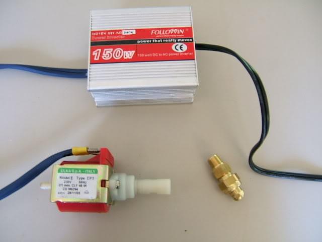

                          Am just working out how to trigger mine, but autospeed again have a great modification to their fuel mixture meter called "low cost intercooler water spray controller", which looks the berries to me, but they have other, more "intelligent" versions. I'm sure you're already onto it though somehow...
                          Still, you can have your squirter motor, I'm going 218 psi at 240V. Perhaps more "car wash" than "intercooler spray"?
                            hmmm maybe i should butcher the water pump from the coffee machine at work, is that what you did greg?
                            2x Caddy, 1x Ducato
                              Flea bay UK actually and MAN they aren't cheap, even on there. RRP just over $100 here! Be a good idea to try and find a half stuffed coffee machine and have at it. The pump you want is an italian ULKA, but then I'm sure others would do.
                              The whole idea of huge pressure is extra fine mist which gives extra evaporation, see Autospeed again "World's best intercooler sprayer".
                              Just remember it is indeed 240V, so be careful and label your wires for the poor mechanic!!!
