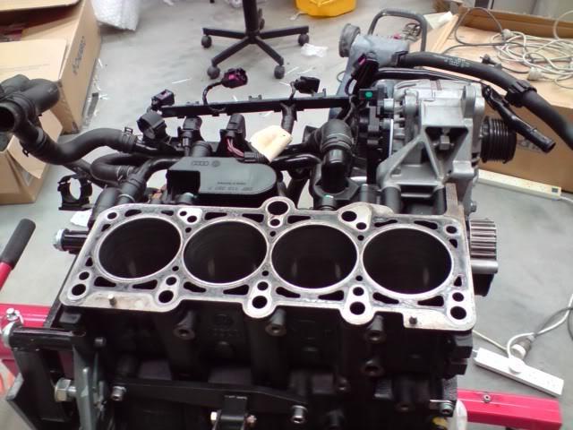

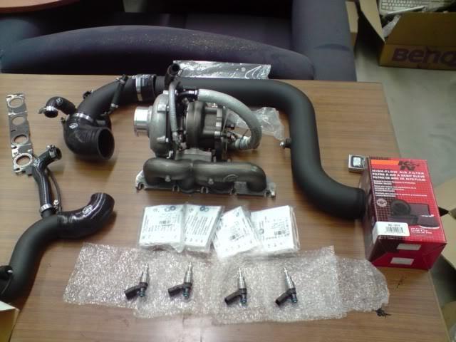

    From this. RSS kit

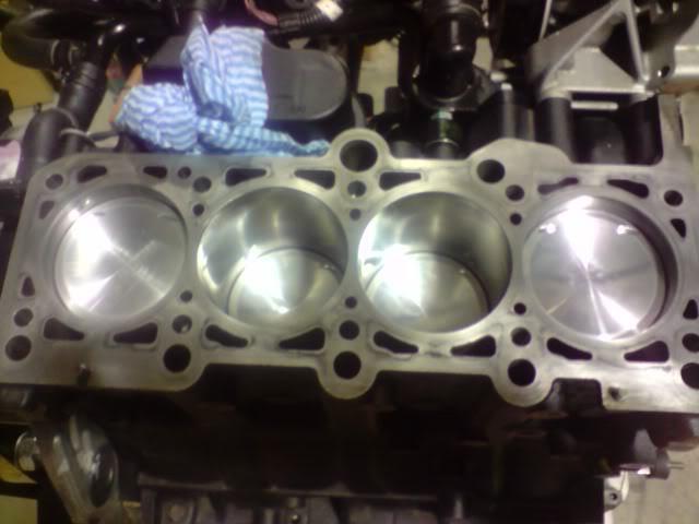

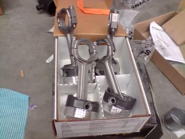

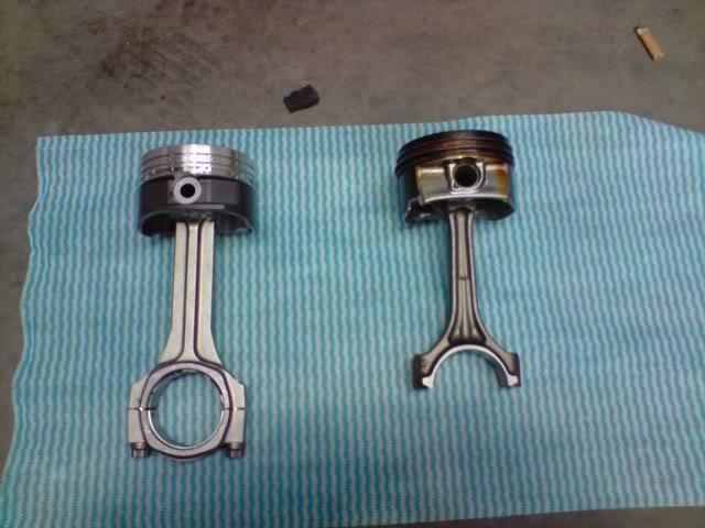

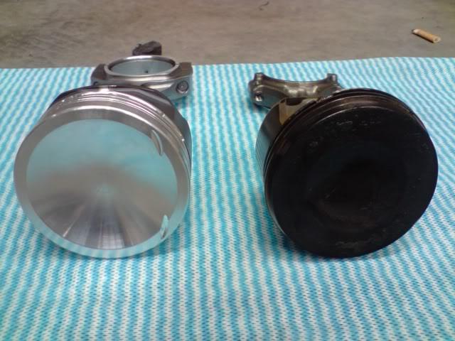

    in comes the RSR internals. Rods and Pistons.

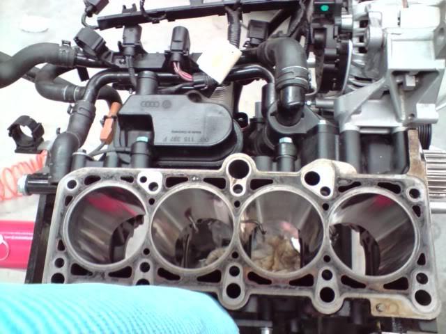

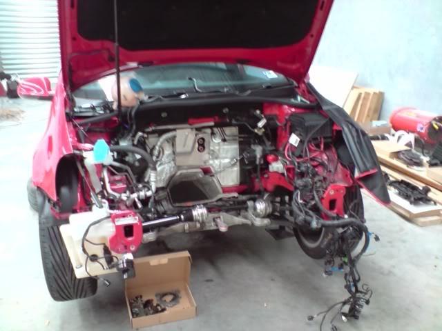

    "stock" engine comes out and apart.

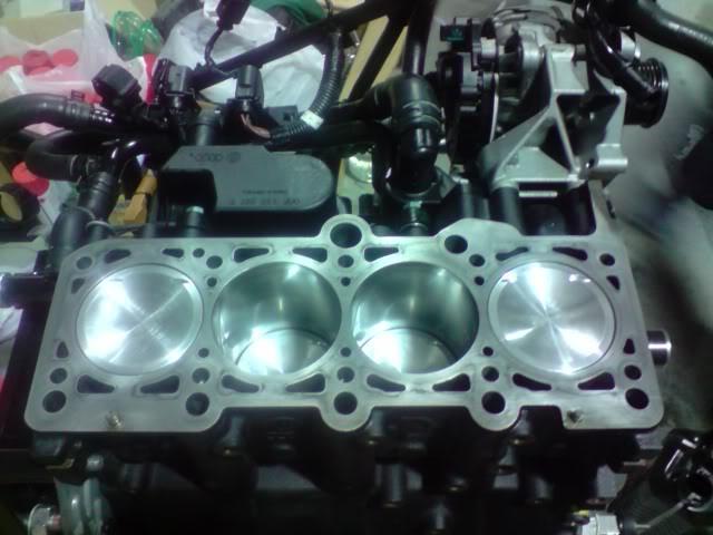

    the Rods and Pistons go in.

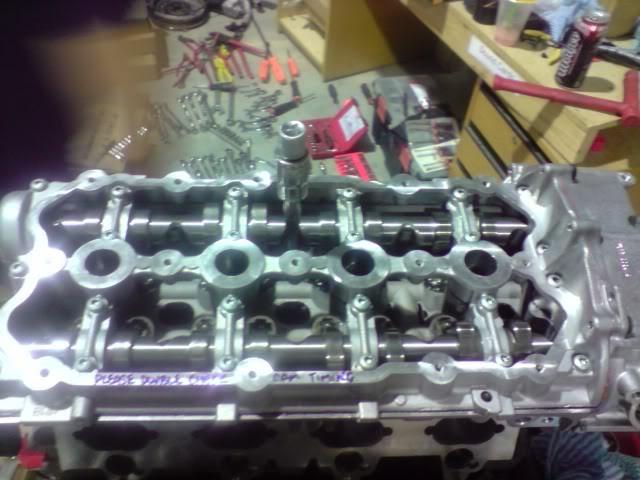

    Head with S3 cams
