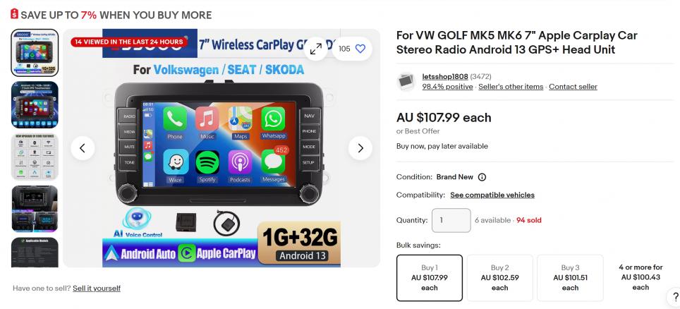

    Car is a 2007 gti Mk5.. and is totally stock.
    Looking to upgrade the head unit..
    Car has an amp under the pass seat ; is this std?
    I bought an ebay head unit but it only worked on the left channels.. and was very crackly. Put the stock unit back in, and all speakers work as per normal.
    Did I buy the wrong unit? Do they need some sort of coding to make them work?
    Any advice appreciated as I thought it was meant to be plug and play.
    Located in Brisbane..
    This is the unit I ordered...
    Hi and welcome to the forum. For $100 im not suprised that it doesn't work very well. I would return it (if possible) and get your money back and keep saving for a better quality unit.

          It took a few back and forths, but yeah they eventually refunded me the price and didnt even want it sent back...
          Forgot to mention, when I first intstalled it, the fuse blew... a good sign that yeah it's pretty trashed inside.
