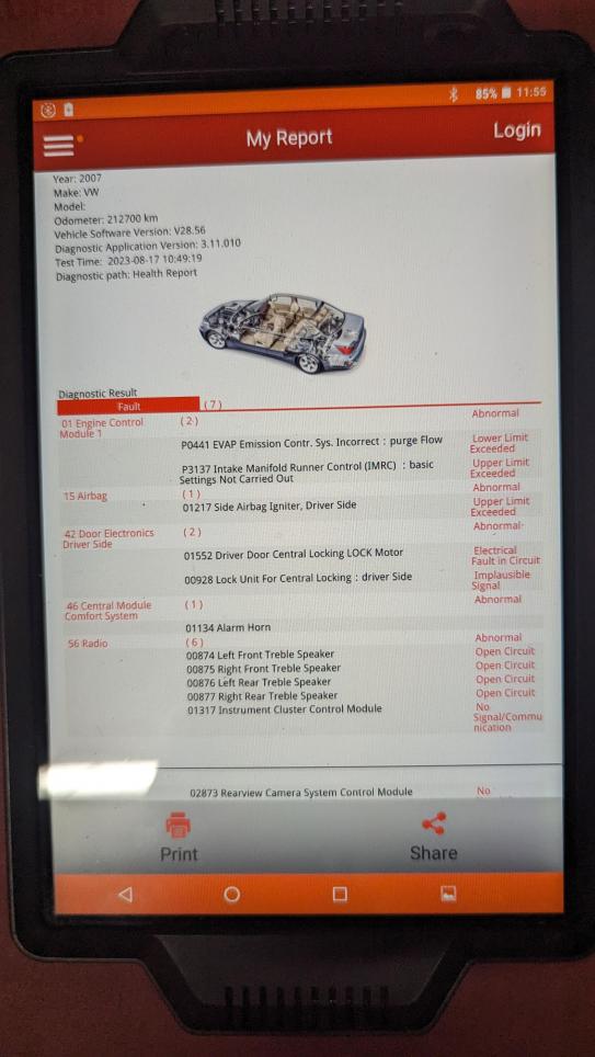

    Hi all,
    I have had my car scanned to start fixing some of the issues with the car. I've taken a screenshot of the salient fault codes. I need advice about the next steps and what I can do myself or what has to be paid to be fixed.

    What troubles is the car having? That scan does not mention if the codes are pending, current or past.
    Is a check engine light or airbag light on?

      P0441 error - this will likely cure this error Charcoal Canister & Hose Se for VW GOLF Jetta 1K0 201 801E 1K0 201 160 BG | eBay . You might also want to replace this part Bosch Evap Purge Valve 0280142431 | Run Auto Parts
      P3137 error - the likely cause for this error will be the motor that controls the swirl flaps in the inlet manifold. Audi, VW Intake Manifold Actuator (A3 A4 TT EOS GTI Jetta Passat 2.0T) 06F133482E by VDO | Europa Parts
      The central locking error are probably the door lock actuators - a very common issue on the Mk5 Golf and Jetta's. You can replace these yourself if you are handy.This should be the correct one for the drivers side door: Vemo Door Lock V10-85-0016 | Run Auto Parts
      The other errors could be related to a low battery or a dead battery. Do the horn and speakers work? Clean the codes and see if they come back.

        Yes, both are on. I'm guessing that these are at least current

          The speakers and horn both work well. I'm not worried about those as the rest of them but it would be good to sort out if possible

            There is a TSB related to the Mk5 and seat connectors for the airbag warning HOW TO: Perform your airbag TSB | VW Vortex - Volkswagen Forum
            The EVAP leak will cause the check engine light; look under the hood for the charcoal canister Lucas_R linked to and see if any tubing is cracked; here is a pic of what it might look like with a cracked pipe (borrowed the pic ) Click image for larger version
