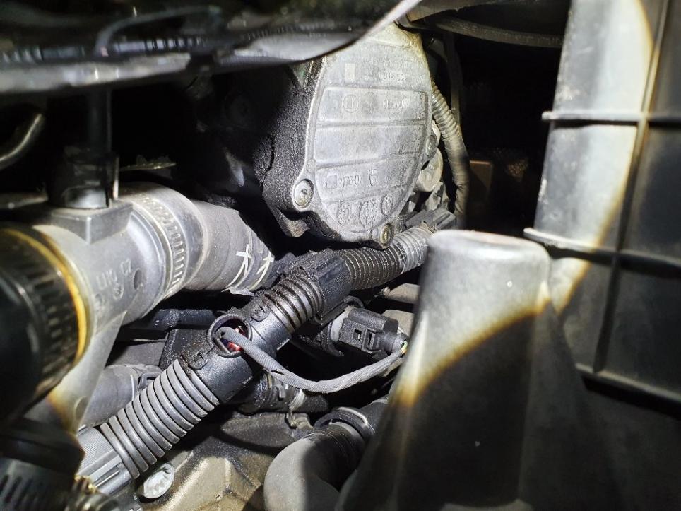

    Howdy all, looking for some advice.
    I've ignored the oil leak in my mk5 gti for too long and after having a quick poke around noticed a bunch of oil coming from what seems to be the vacuum pump.
    Thick oil deposits can be seen under the pump and coating the electrical cables below.... There is even a pool of oil in the crevace on top of the dsg.
    A quick google shows two o-rings inside the pump housing. Should I bother replacing these or is usually the pump that needs replacing?
    Your suggestions are appreciated!
