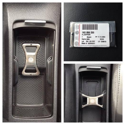

        Just curious, it looks like a bottle opener shape in the bottom of the cup holder. What is supposed to be there, I've always wondered.
        MY08 Golf MkV GT-Sport
          It is actually for a bottle opener. The car would've originally come with one. It also acts as a divider to make two separate cup holders. You can pick them up cheap on eBay.
            If that's the case, too hard. It just stays open...
