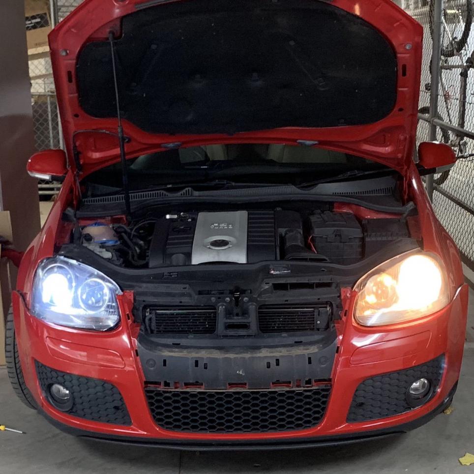

    Mid change over to these...
    VW Golf Mk5 Projector Headlights 2005-2008 (fits halogen headlight models) - Supernova Lighting
    I think the authentic projectors require some wiring modification - not 100% sure.

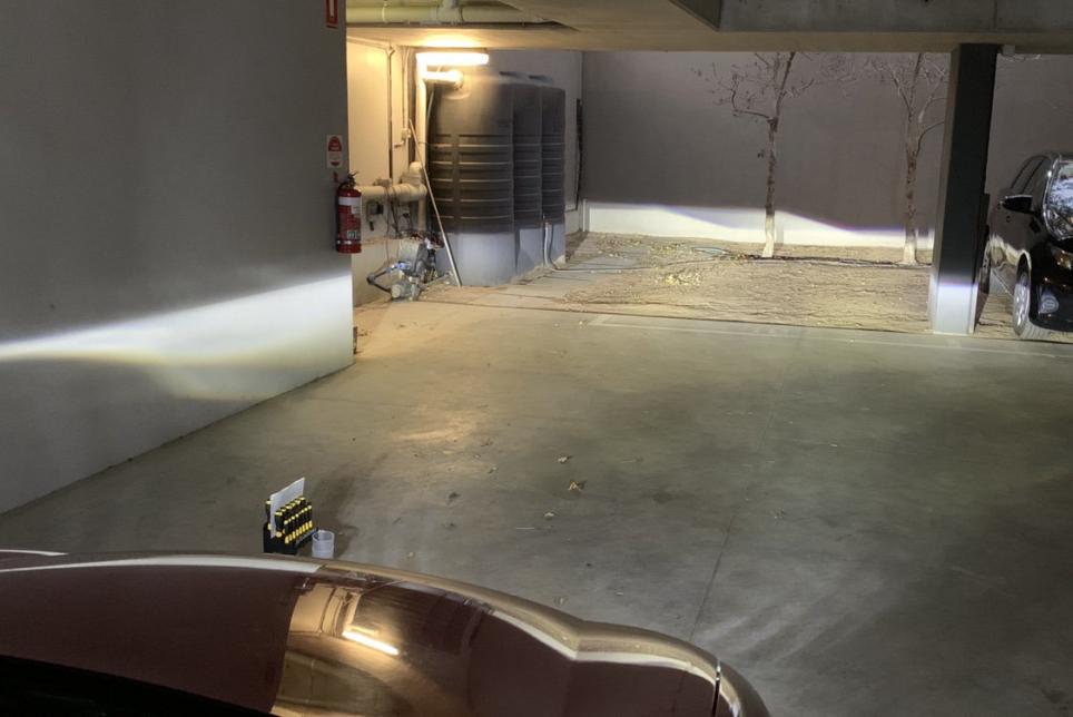

            I've done a projector retrofit on my mk5 not long ago, it was a fair bit of work but well worth it in the end. The light output and beam pattern is so much better.
            The retrofit was about half the price of the reproduced projectors somebody else has linked above... I'm not sure what the quality or light output on those would be but maybe worth a shot.
            Also, I tried HID in the standard housings and I didn't even bother driving it, it was glare city...

              Hi, Adey wanted to ask if you used the factory projector headlight and rewired it?
                I've used an after market projector by morimoto
                Bi-Xenon: Mini H1 7.0 - HID Projectors from Morimoto HID
                They are one of the best after market projector kits but as I mentioned above there is a fair bit of work to install them.
