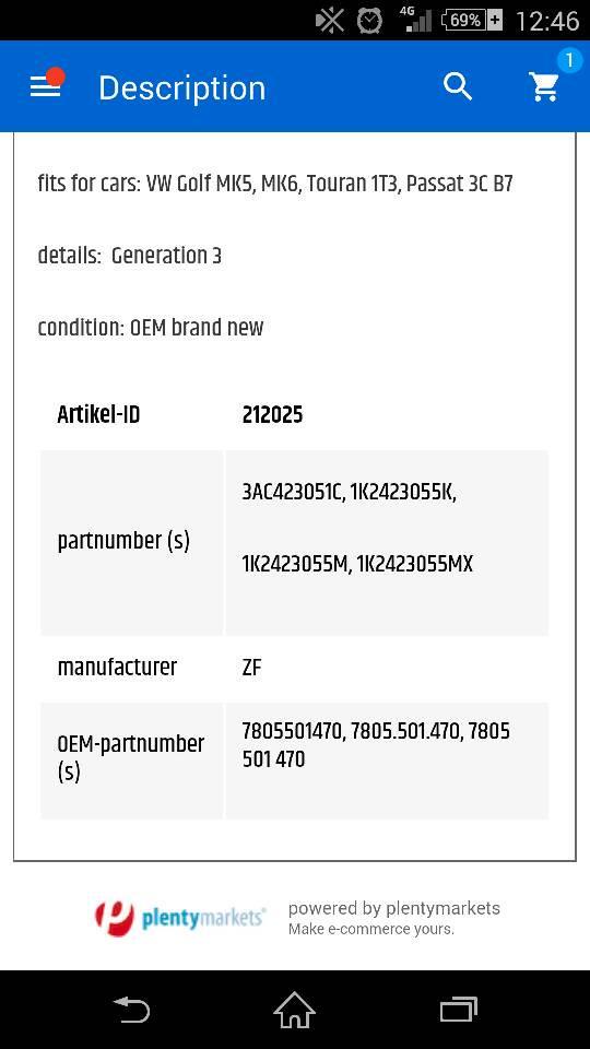

    Interesting enough online can get a gen 3 rack for roughly $700 new from UK. Will this fit the R32? Checked twice just want to be sure. I can source the new harness too for $120.
