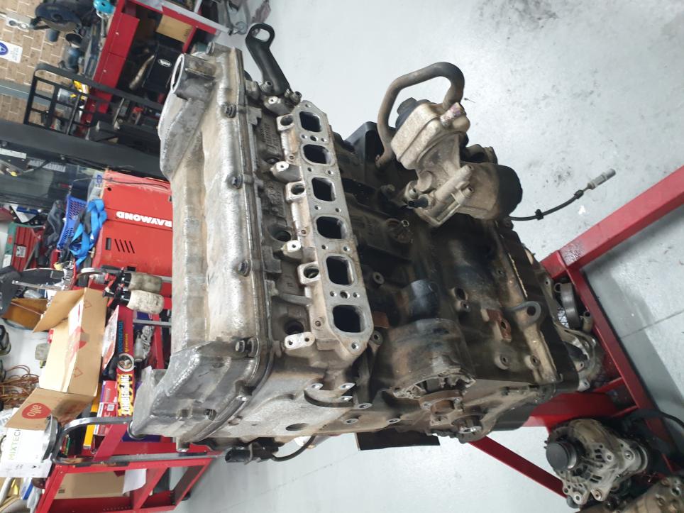

      Start of 2017 i smashed another sump and me being an impatient and stupid 18 year old i thought getting it home would be the best move, leak didnt look too bad but little did i know this wouldnt be the case and i had a bottom end knock by the time i got home.
      so i went and bought a 2 door mk3 with a vr6 swap, off my 2 best mates.
      heres a link to that build if you are interested ( VR6 swapped, Voomeran flares and Lip etc etc )
      then at the start of 2020 i thought it was time to move on from the golf and finish what i started with the Bora.

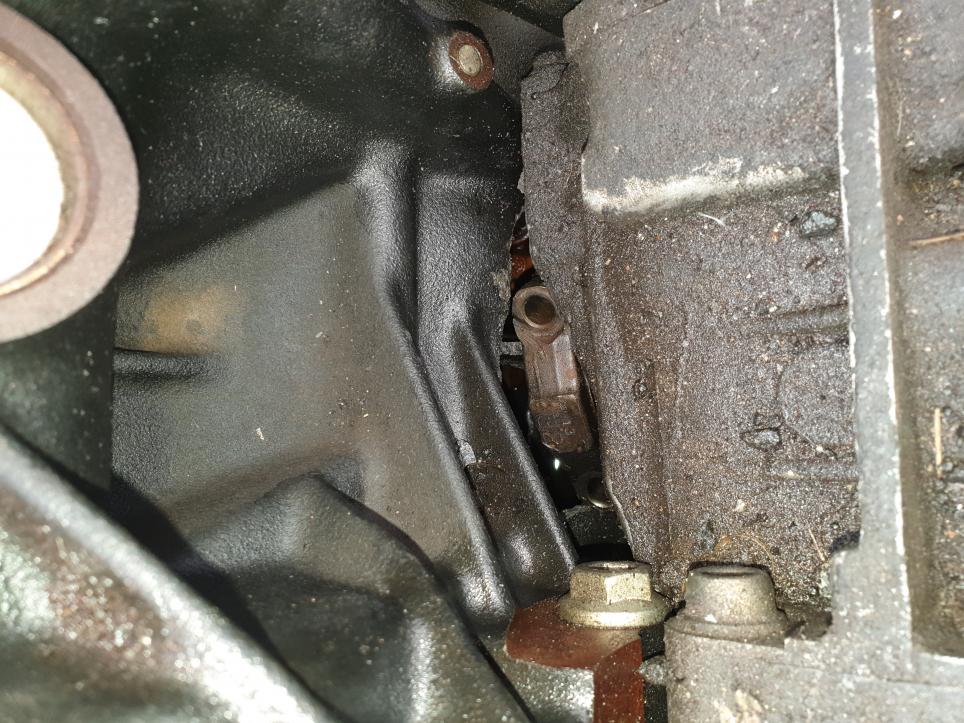

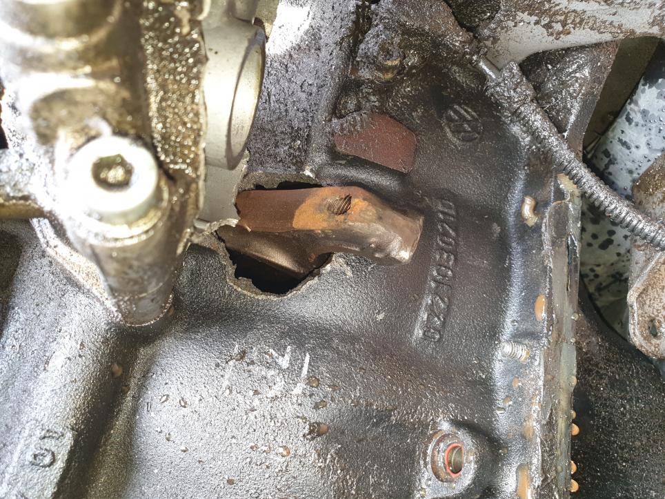

      i then moved house and had to move the Bora there, so filled her up with oil and attempted to drive it to my new place. Threw a rod through the block lol.
      fast forward a little more and we here.
      Bought a BDE 2.8 24v for $400 ( shouldve bought a 3.2 or 3.6 but theres a stupid tax on those motors here in aus and to find a decent one that doesnt need too much work they are around 2k+ )

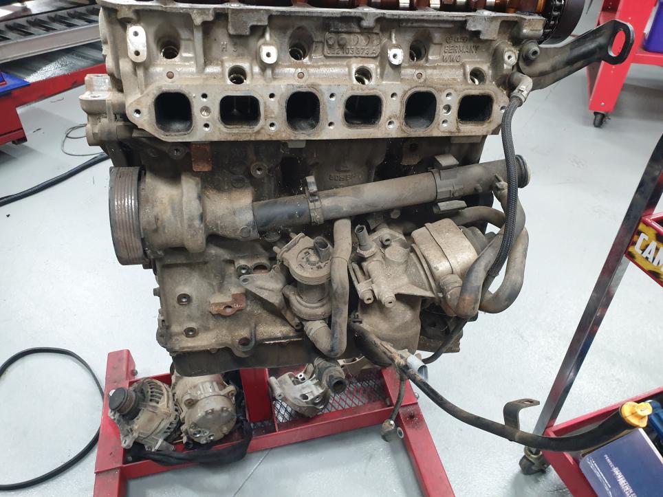

      so here is the aftermath of the AUE 24v
      20200906_144425 by Bradley Edwards-Millgate, on Flickr
      20200906_144419 by Bradley Edwards-Millgate, on Flickr
      20200905_164045 by Bradley Edwards-Millgate, on Flickr

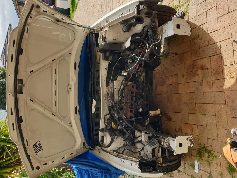

      Proceeded to pull the AUE out
      20200906_144411 by Bradley Edwards-Millgate, on Flickr
      20200906_144444 by Bradley Edwards-Millgate, on Flickr

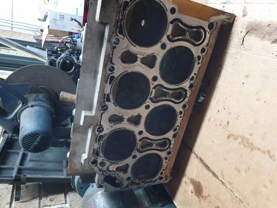

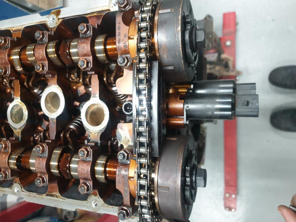

      Now onto the BDE "build"

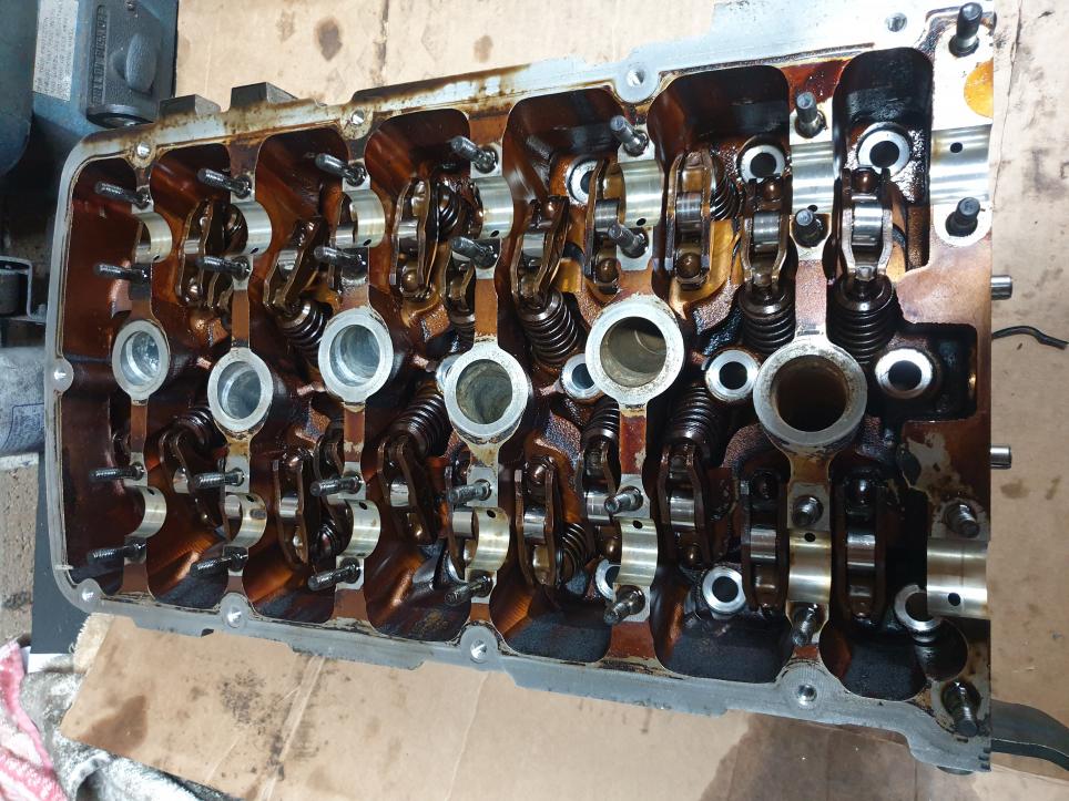

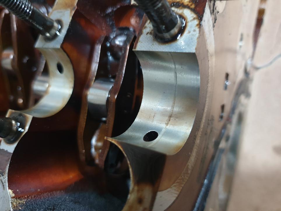

      Came out of another bora with around 100,000kms
      unfortunatley after pulling it apart found that the motor didnt have good service history and lots of carbon build up.
      20200529_181521 by Bradley Edwards-Millgate, on Flickr
      20200529_172126 by Bradley Edwards-Millgate, on Flickr
      20200529_171049 by Bradley Edwards-Millgate, on Flickr

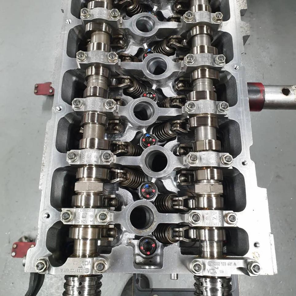

      then found that the head needed a rebuild and clean
      20200604_171221 by Bradley Edwards-Millgate, on Flickr
      20200706_141614 by Bradley Edwards-Millgate, on Flickr
      20200706_141623 by Bradley Edwards-Millgate, on Flickr
      20200706_141639 by Bradley Edwards-Millgate, on Flickr
      20200706_141854 by Bradley Edwards-Millgate, on Flickr

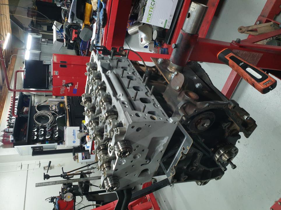

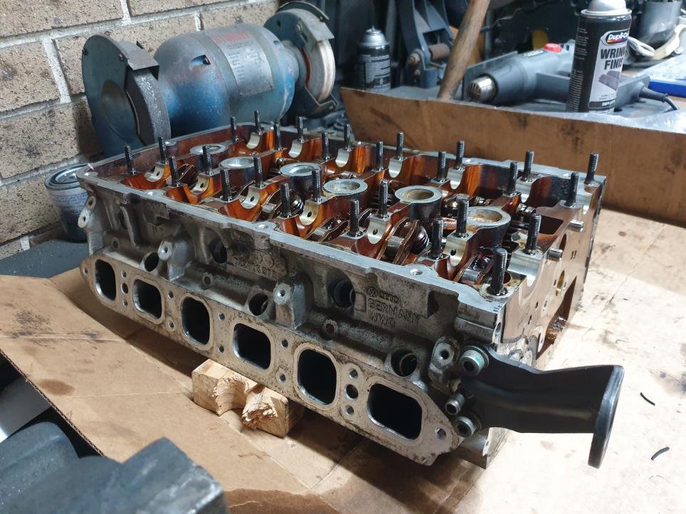

      So sent the head away and got it back fresh and new
      pretty much everything was cleaned and linished to get rid of the deep scratches in the cap lobes and caps.
      New Valve stem seals etc etc
      New headgasket
      VRS kit
      etc etc etc
      20200827_200509 by Bradley Edwards-Millgate, on Flickr
      Dont mind all the paint marker, im a mechanic by trade and its just habit for following torque patterns

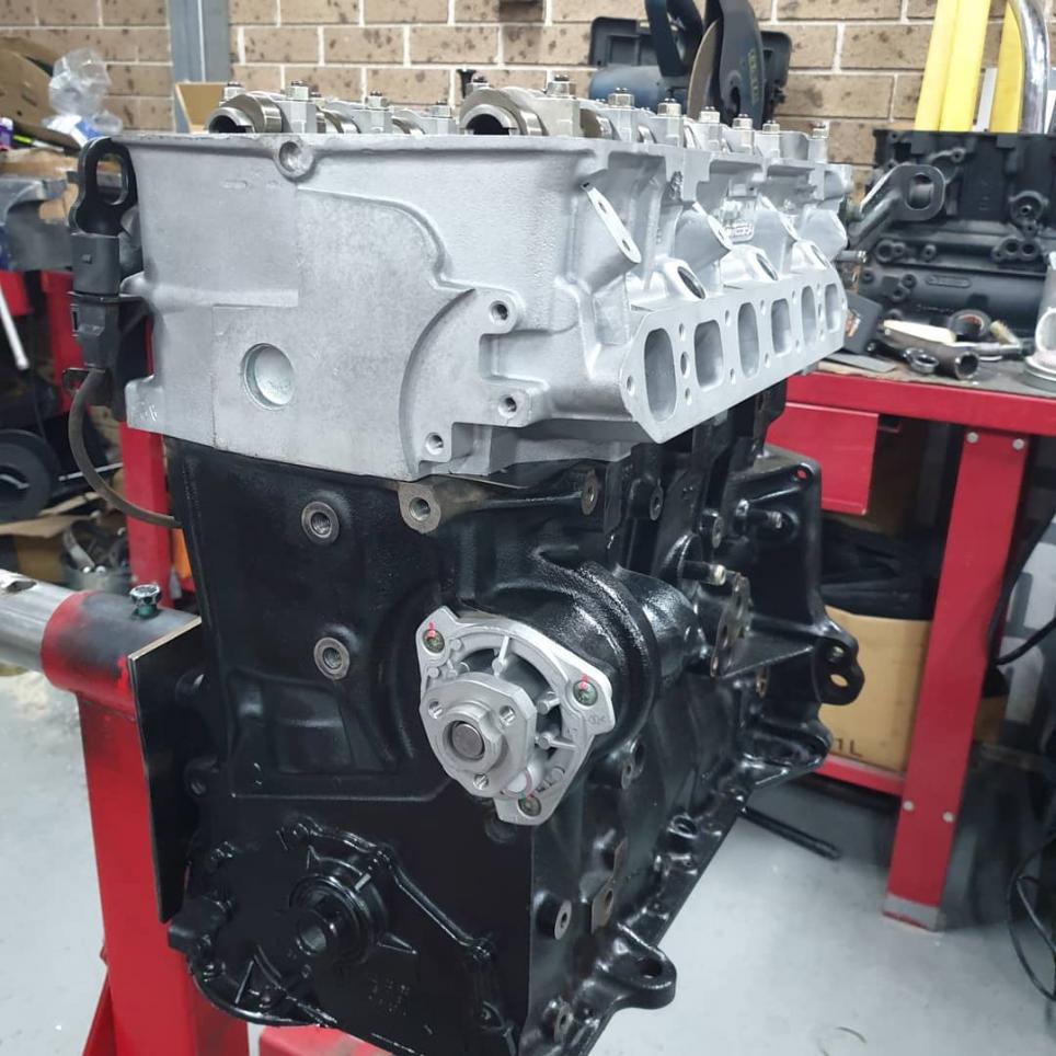

      Cleaned up the block and sprayed it black to give it a freshen up
      New waterpump bolted in as well
      IMG_20200828_124845_768 by Bradley Edwards-Millgate, on Flickr

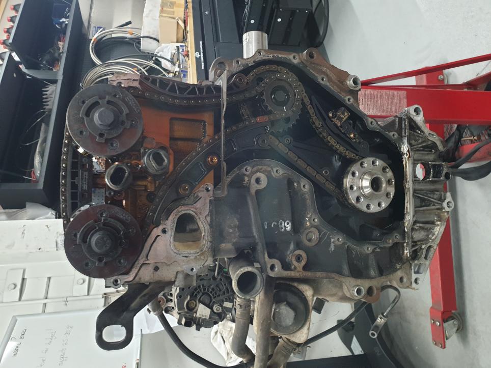

      I spent aout 30min tonight on finishing the timing chains to find out that im missing the upper chain guide for the VVT bridge or cam bridge whatever you wanna call it.
      soooooo need to track that down now. 1 step forward 3 steps back
