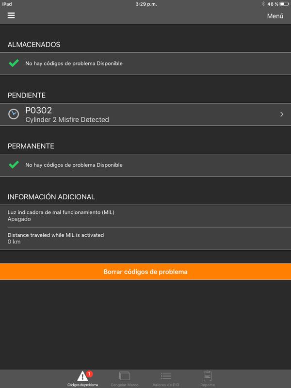

    Scan for codes with my OBD FUSION and it throw P0302 Cylinder 2 Misfire Detected

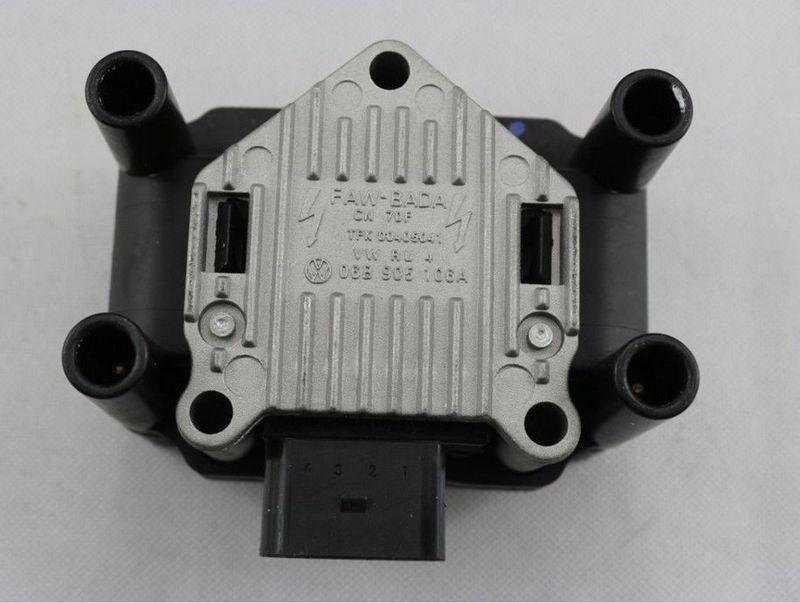

      Engine is a 4 Cylinder 2.0L that use one coil pack were the four plugs wires goes conected (Is not Distribuitor) It also does not use coil over the plugs.
      THX
      Here is a pic of the coil pack it use. I found the pic on the net.
