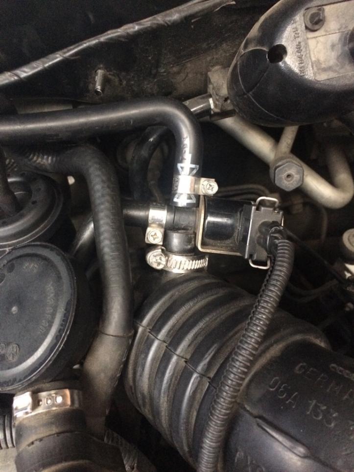

                  Well... Ordered a new OEM n75 and fitted it today, made sure it was orientated correctly and all that, and got even LESS boost... approx. like 5 maybe 6psi. I was testing my old n75, and while the valve is closed, if i blow hard enough through the long outlet that goes into the TIP a tiny bit of air leaks through. When i blow through the new one its completely air tight but it gives me less boost... So i'm just gonna run the old one for now.

                        Just check it's fitted in the correct orientation. As the boost sounds like its on actuator pressure still. A difference of 1 PSI doesn't covince me that there's a difference between the 2 that you have tested.

                          Yeah thats how I had it orientated, It was $60 of ebay so its probably just a dud, theres no product number or anything on the actual valve itself so yeah. What you get for going cheap I guess. Thanks everyone for your help, ive been thinking of eventually upgrading to a K03s so i guess ill be getting it earlier rather than later than see what happens from there.

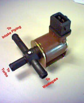

                              Shouldn't be a dud. You can't really install the N75 the wrong way, cos the wiring clip and loose 2 pipes won't reach. Longest fitting on the N75 goes into the intake, the opposite one connects to the wastegate line.

                                I'm sure it was orientated properly so that wouldn't be the problem. I'm getting the wiring professionally done soon with a new plug as at the moment it's soldered quite poorly as they were cut when I bought the car. But when I was talking to an electrician I know, he said it would still work and shouldn't be a problem but it's just not strong kind of thing. This should be done within the next two weeks and I can rule out/find my problem.
