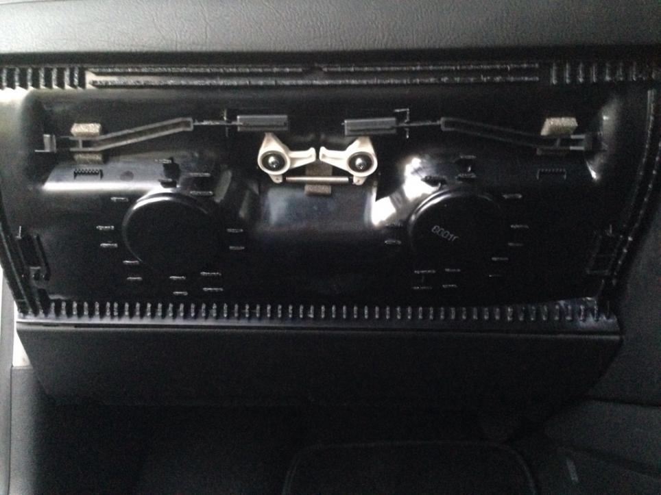

          Mine broke last week and I fixed it whilst still in the car!
          Used a flathead to pull the front skin off, put back together the pin mechanism with screws and washers holding them in place from where they snapped and gluedthe skin back with tarzans grip then held in a few spots with masking tape over night! (Better off using a different glue tho) Pretty easy imo! There's no need to pull the glove box out for the fix at all!
          Here's the mechanism all back together with screws and washers in the centre!
          Goodluck!
