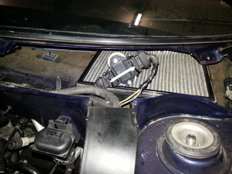

    Decided to start on other parts of the engine bay as I get a battery to start the car.
    Relocated my ICM to the cabin filter since I changed my CAI and had no where else to put it.

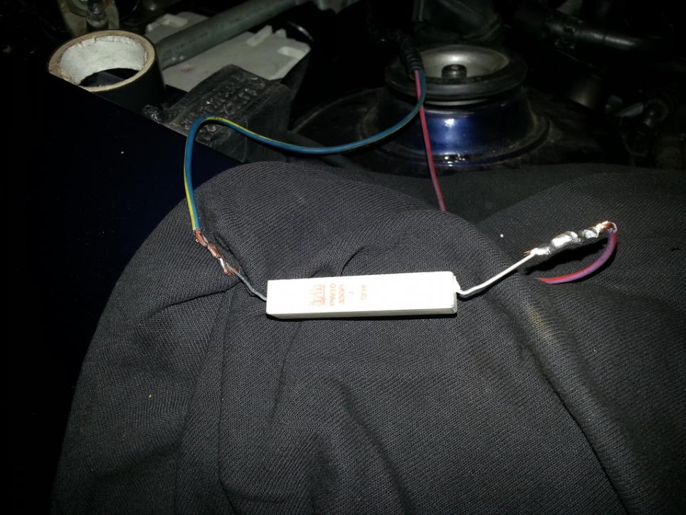

    Also did the resistor trick for the charcoal canister removal.
    Found an old ecu plug from 1.6 loom so I managed to swap over my broken clip for a good one!
    Once I get a battery I can start it up and see how it runs, may need an a3 throttle body with no cruise control to actually run the ecu properly. Seems Gav cant transfer over the tune from ecu to ecu so this may be the only way

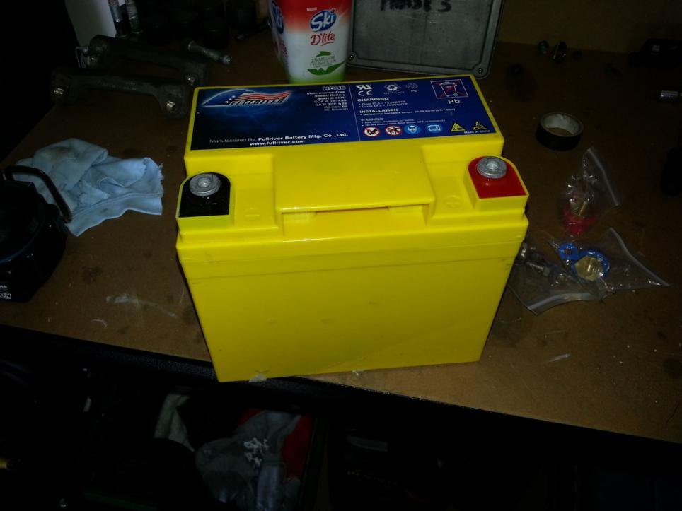

          Hey guys so the battery didnt arrive until this week but glad it came! Full river HC35 nice and compact for my boot install

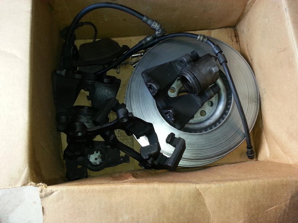

          Also picked up some 312mm front brakes from Lachlan! Will make a huge difference from the 1.6 brakes! Was good to catch up mate!
