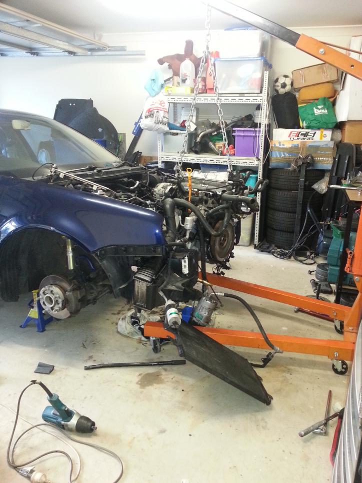

                      So its been a few days so time for an update!
                      Last weekend took engine out to do my reat main seal and put gearbox back on and decided whilst its out I will be going stage 3! Would have been so much harder to take it all out again so I guess its time.

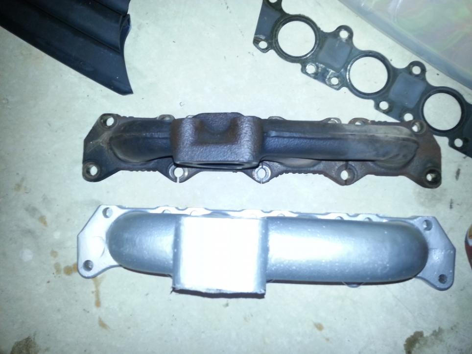

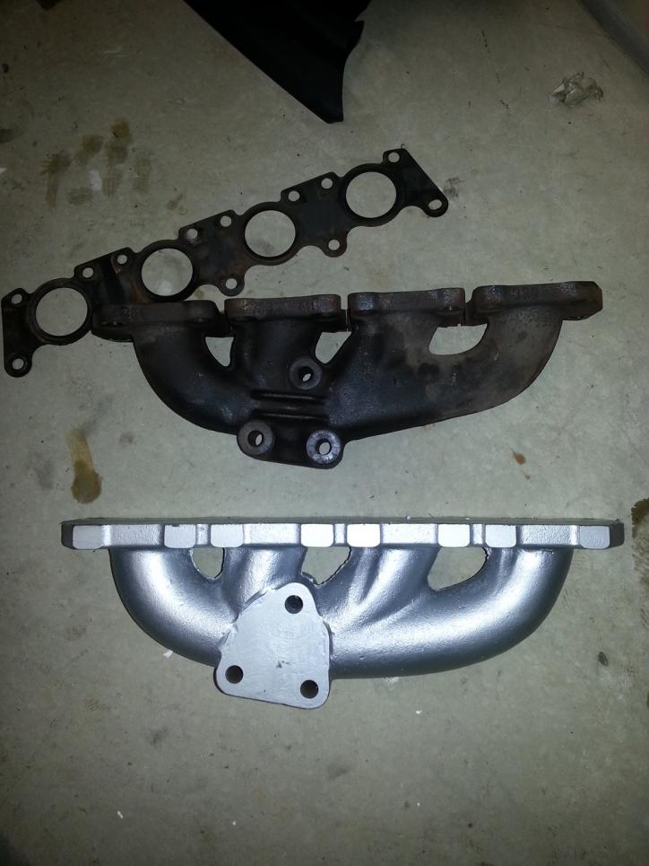

                      High flow manifold

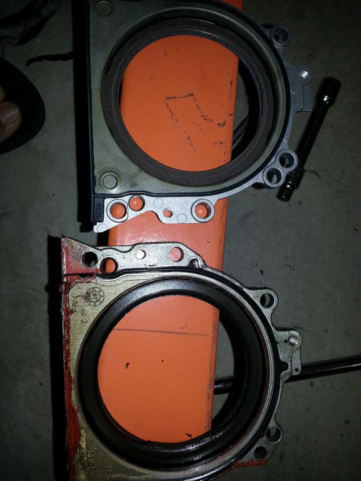

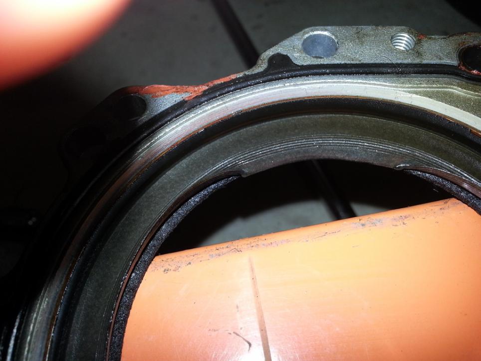

                      So the rear main seal was fitted from factory and wll there my oil leak, so put mine in so carefully so I wouldnt fold over the seal
                      Heres the folded seal
                      And old vs new

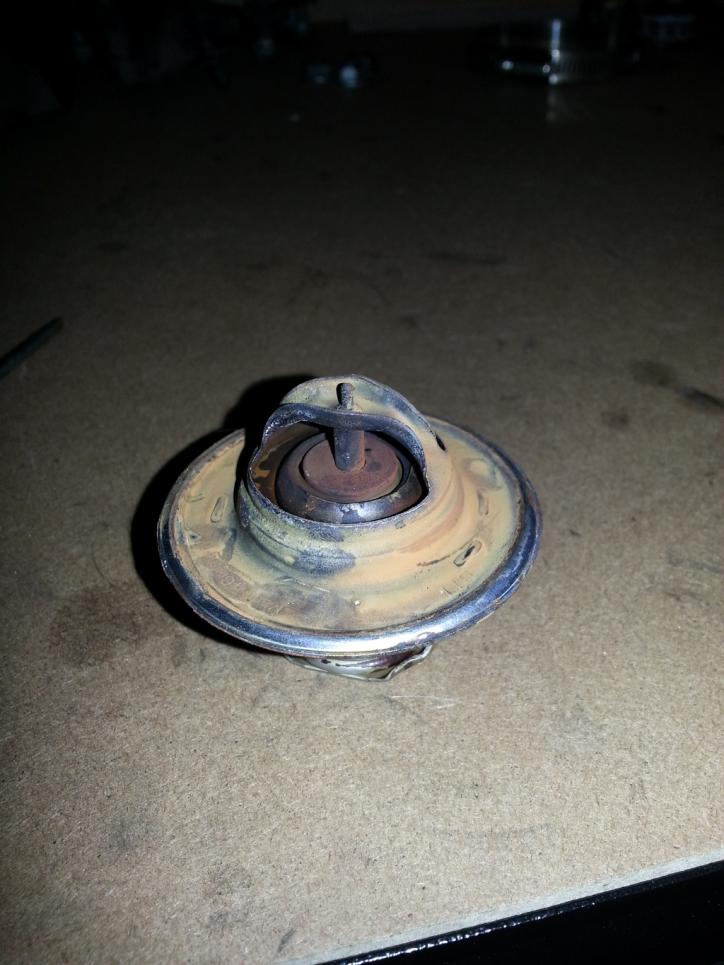

                      Also changed my thermostat

                          Did the new main seal come with a plastic insert to protect it during the install? It goes over the crank so the lip doesn't get caught.
                          Gavin
                          • #43
                            Yea it did Gav i didnt know what it was tbh but seemed straight forward. I dont know how the last one was put on wrong
                            MY MK4 BUILD

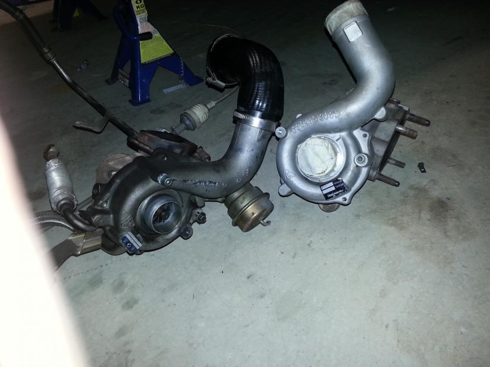

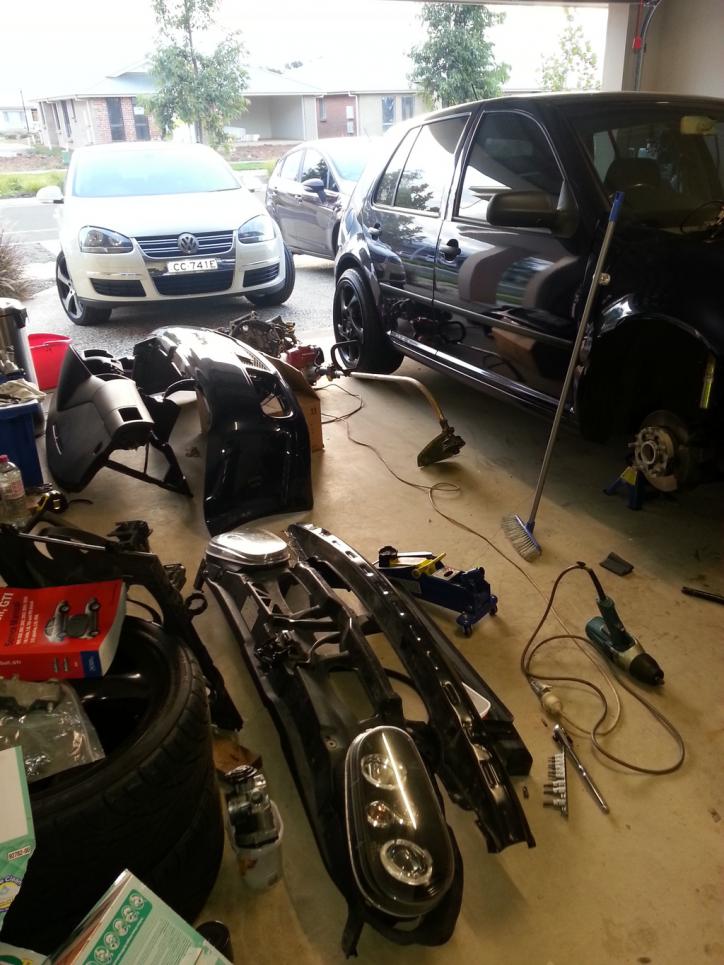

                              Tonight efforts tonight
                              Old k03 and manifold taken off, all cooland hose and oil feed line transffered to the franken turbo and all new seals.
                              New vs old
                              And heres where the magic happens!
                              MY MK4 BUILD

                                Looks like good progress there Anthony.
                                (I see the whipper-snipper is in for some attention too?)
