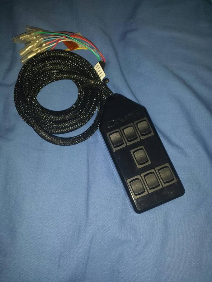

    i bought a AVS switch box off eBay.com as there cheaper with postage then buying on in aus , pictures below is the same one i have coming .

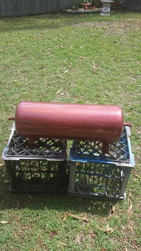

    as for my air tank and air gauges i got given it from my brother and i ended up painted the tank to what i like ( its not finished yet)

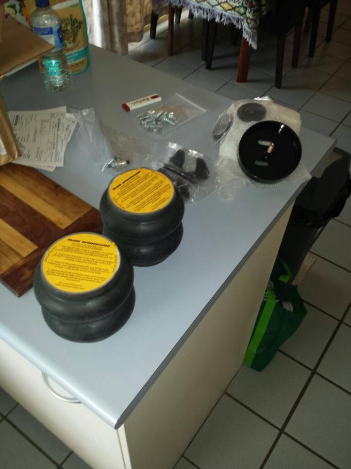

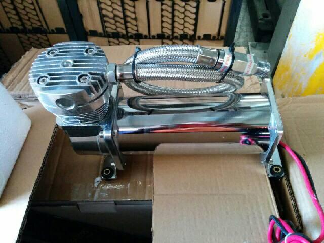

            I received my switch box, bags and brackets last week and my compressors arrived yesterday i also got a moisture trap to stop any water going in to my tank and bags from the compressor

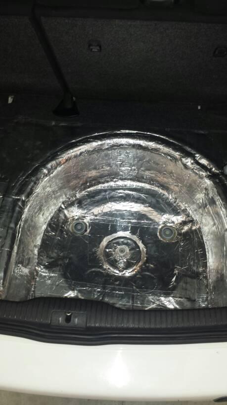

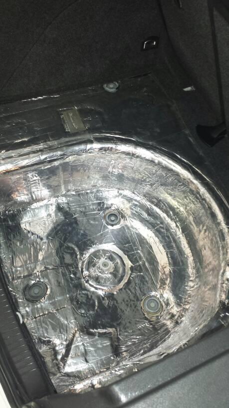

            also over the weekend i put some sound deadening matting on the boot floor and when i make the false floor to house everything i will also sound deaden that

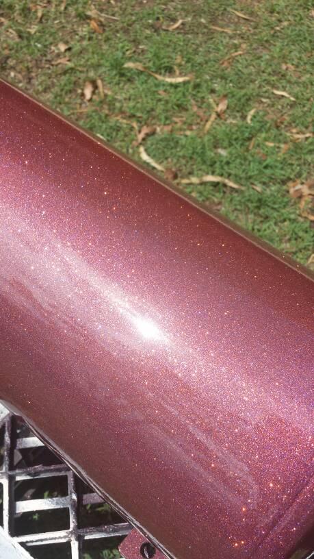

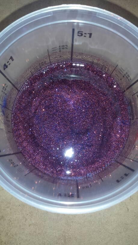

            i have also been mucking around with the tank and put some extra flake on it , its now got copper flake with a small amount of purple throw it , i just need to do a final clear on top and the tank is done

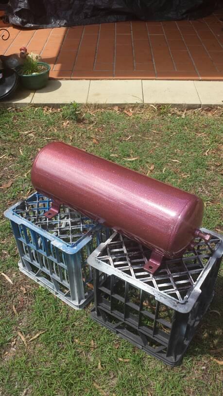

                      finally finished my tanks on friday chooper flake with a hint or purple flake on top

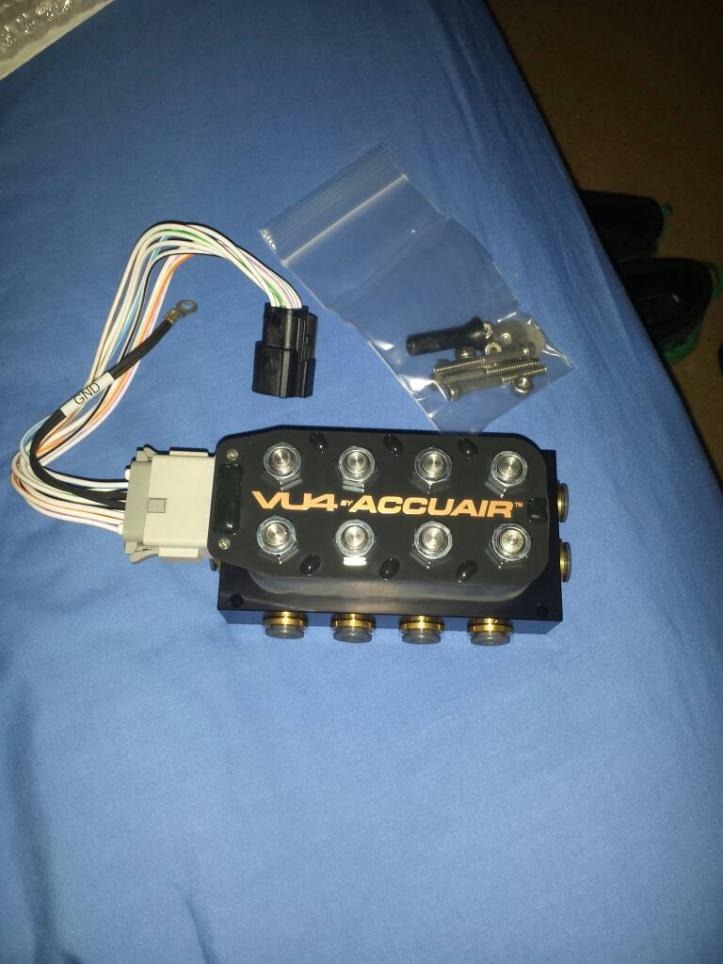

                            Got my Accuair VU4 valve block , the rest of my fittings and all the timber for my false floor , ill be making the floor on Wednesday arvo
                            just gotta wait for the last few parts now then i can start installing cant wait
