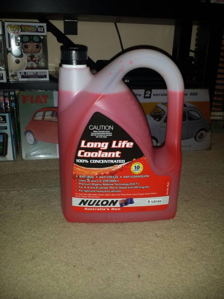

what coolant to run green or red/pink ?
That guys a f wit. With an answer like that it's a wonder if the guy knows there's actually an engine in a car!!!!Originally posted by aaron001au View PostI just grabbed some of the red nulon that is recommend for the mk4 , I'd rather have the right stuff in there just for piece of mind ....
I went to vw and asked and the guy looked at me strange and said you can run just water and it will be fine .....
Hahaha. Probably owns an old vn or somethingOriginally posted by grtuned View Post...With an answer like that it's a wonder if the guy knows there's actually an engine in a car!!!!
If you don't want to pay for the exhorbitant VW pricing for genuine Pink coolant then buy a bottle of Penrite pink 6+ year coolant. It's a bit cheaper and is approved for us by VW themselves. Be sure to check the back of the bottle to look for the G12+ standard.
But as above, get the green coolant out. It's not made for VWs. Pink coolant apparently has addititives in it that the engine and pump need.Originally posted by MightyCarModsI'd rather lose by a mile because I built my own car, than win by an inch because someone else built it for me. Your car is your story, so don't let someone else write the book.

I got this its what was recommended to me buy a few other vw owners I know and the nulon site says this suits my mk4
