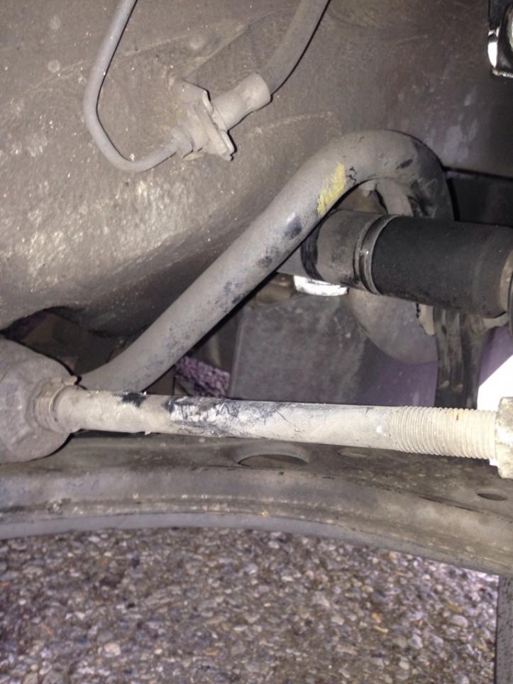

            Haven't done much over the past few weeks with getting my exams out the way except finding that my swaybar and driveshaft seem to be having a war againstt eachother [emoji23]
            Will sort it out during the week but may order adjustable droplinks and get them strengthened by an engineer when set at the right height (trying to defy the odds [emoji39])

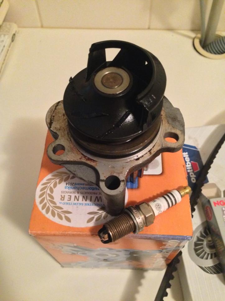

                Finally got a chance to get the beast into my mechanic after having a bit of a neglected life with the previous owner.
                Timing belt, waterpump and spark plugs were replaced, with a full service
                Waterpump was in multiple pieces and the spark plugs looked roasted to a crisp [emoji16]
                I'm glad I can drive it without having to worry about it anymore!!

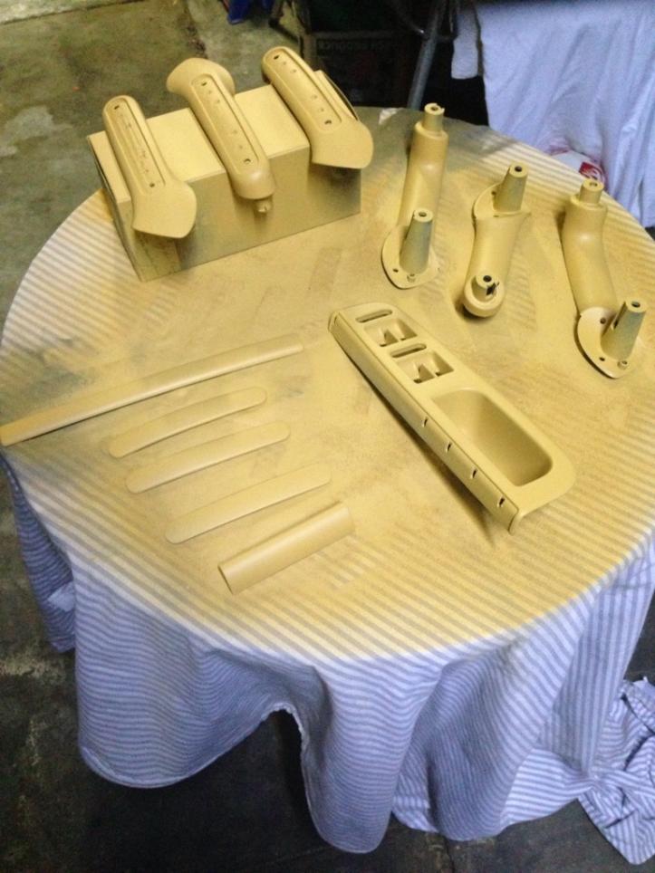

                    • Currently in the process of getting rid of all the annoying rubber painted trim and fake cracked woodgrain in the car!
                      So far it's looking a lot better than the first coat and almost ready for some paint
                      Debating on how I'm gonna do the centre console area but I'll see what I come up with
                      I've gotten the rubberised paint off with a scourer already but not sure if I'll paint it

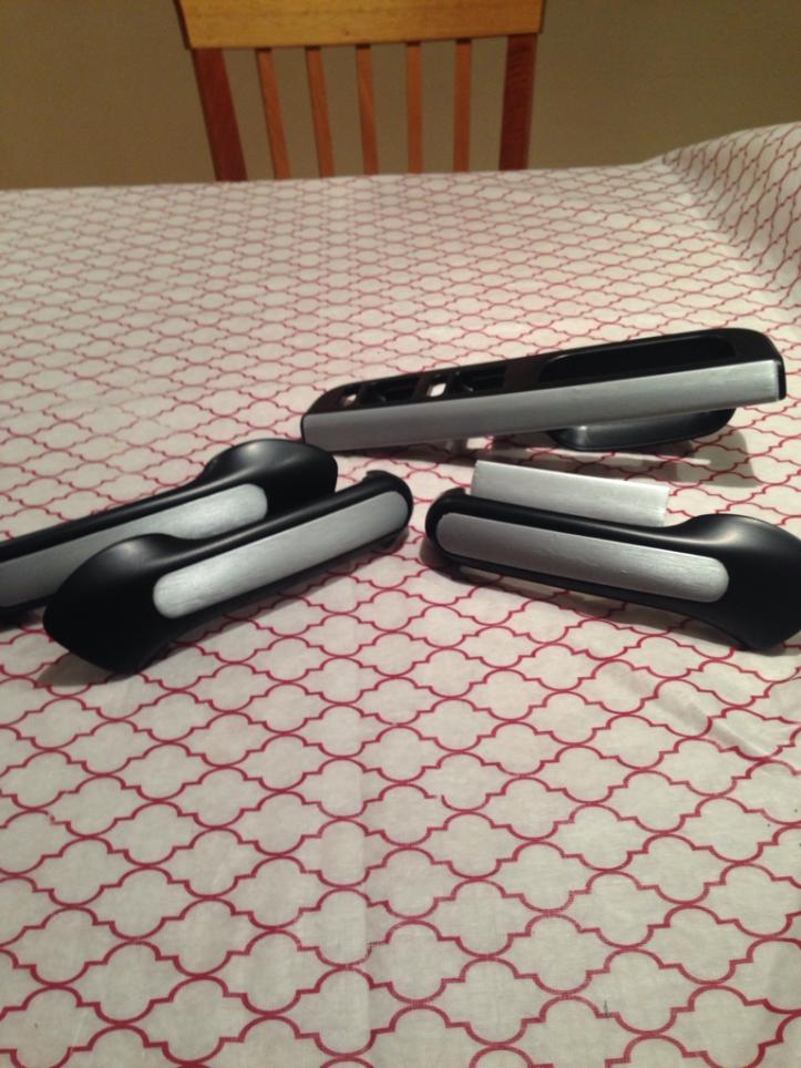

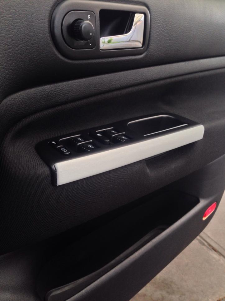

                        Finally installed my freshly painted door handles the other day and I'm very happy with the way they came out
                        I had ideas of painting the woodgrain trim gloss black, which I did but due to the nature of the paint I found it to scratch too easily so I went and used the vinyl wrap I bought a few weeks back

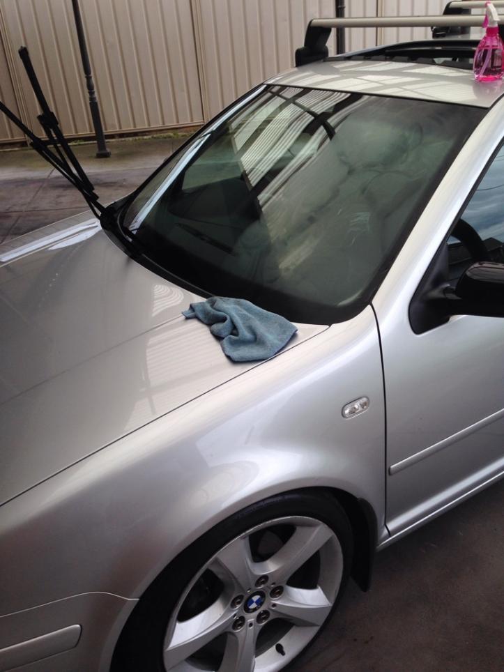

                        Got sick of looking at tree sap on my windows and after trying multiple methods I ended up using ultimate compound and tech wax and came out great

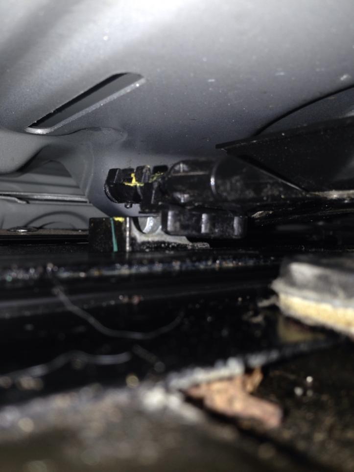

                        Then today after getting fed up with a rattle in my sunroof I pulled my headliner out to fix it
                        It turned out to be a small plastic clip that supports the tilt mechanism on both sides that worked their way off to be metal on metal
                        Those pieces were sitting against the drain pipes on the inside
                        So once clipped back in place it was fixed

                          • Originally posted by caputo9 View Post
                            I've got a sap issue with my windscreen - so did you basically cut and polish/wax the windscreen? Have tried so many methods to try and get rid of the crap on my windows, from windex and newspaper to a few cleaning products but none seem to work.
                            Cheers
                            .:R32
                            8L S3
                            Mk3 VR6 - SOLD
                            Flickr
                            • Originally posted by drucejnr View Post
                              Cheers
                              pretty much man haha
                              i tried multiple methods off google and nothing would work, tried polishing/waxing and it came out alot better
                              not 100% but its nowhere near as noticeable
                              im probably going to get my windows opti-coated in the near future so will be good to have it removed properly
