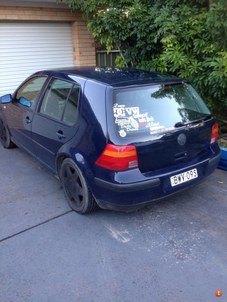

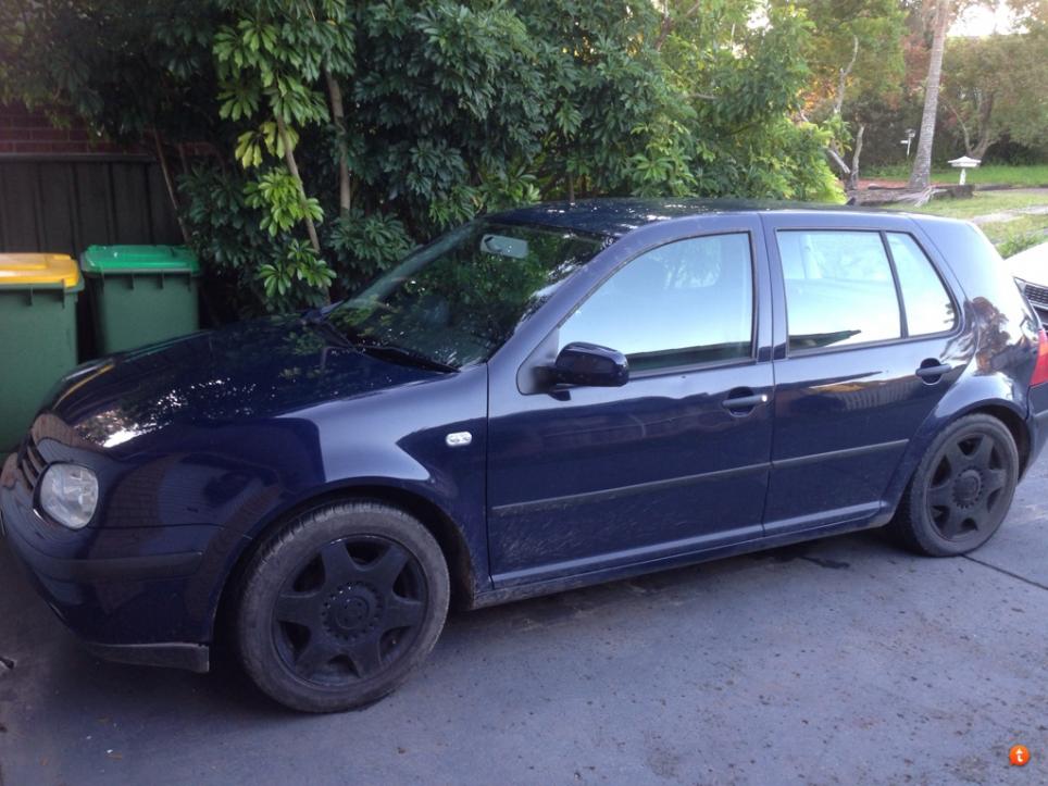

                            Here she is, needs a bit of a tidy up but it's on the way. For now saving for some treats from ECS for some coilovers and tie rods to begin with then find some new wide deep dishes more than likely with some low profile tyres
