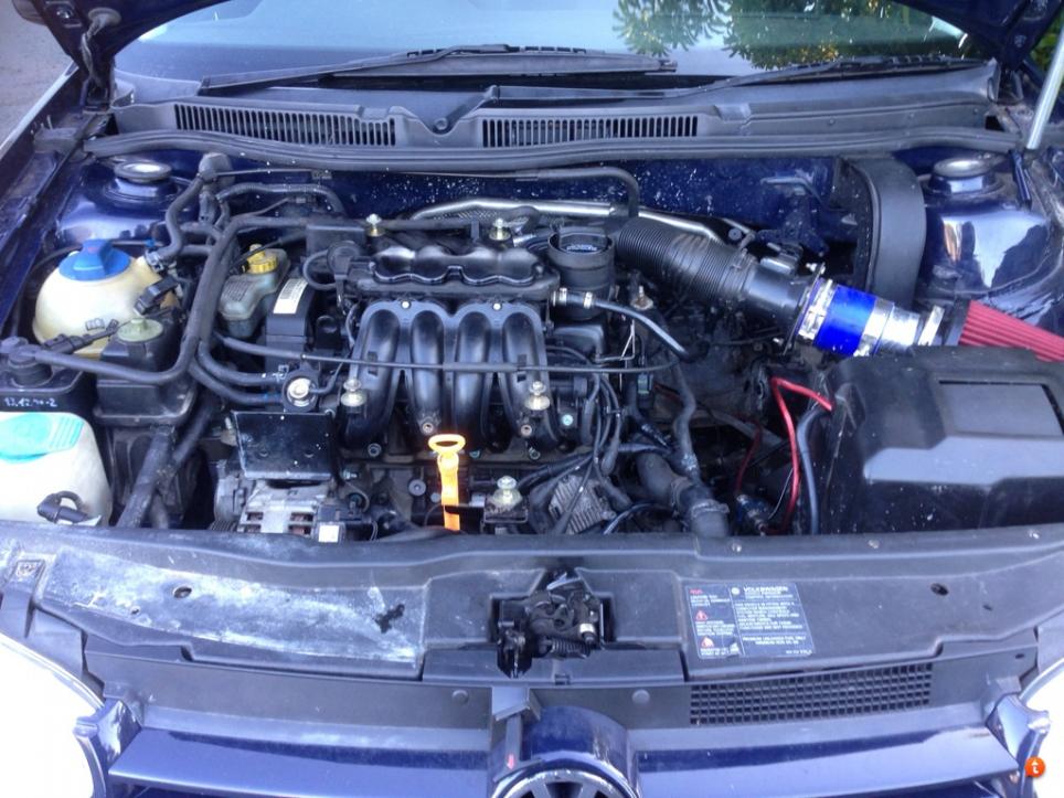

    Planning on getting my 1.6 started today for the first time in about 6 months.
    Was going to get some coolant and some cheap crappy oil to start the car and let it idle, drain the cheap oil and replace with good oil. The last oil I put in was Shell's 5W 40 I'm pretty sure.
    Any advice, hints or tips???
    Putting the cheap oil through to heat it up and thin it out so there's no chance of any crap sitting in the sump
      Topped up the coolant and changed the oil. The car starts but stalls itself within 2 seconds which seems to me it'll be something to do with the fuel, before the engine swap the fuel pump, lines and filter were all working fine. There's ¼ of a tank which I just put in and still no start. Charged the battery the other day, put my multimeter across the battery and was reading 12.5V but when I tried starting it again everything had reset like the battery had died so had to put it on charge again. Can anyone give any suggestions? Wasn't sure whether it might need to be half full for the fuel pump or sensor to kick in?

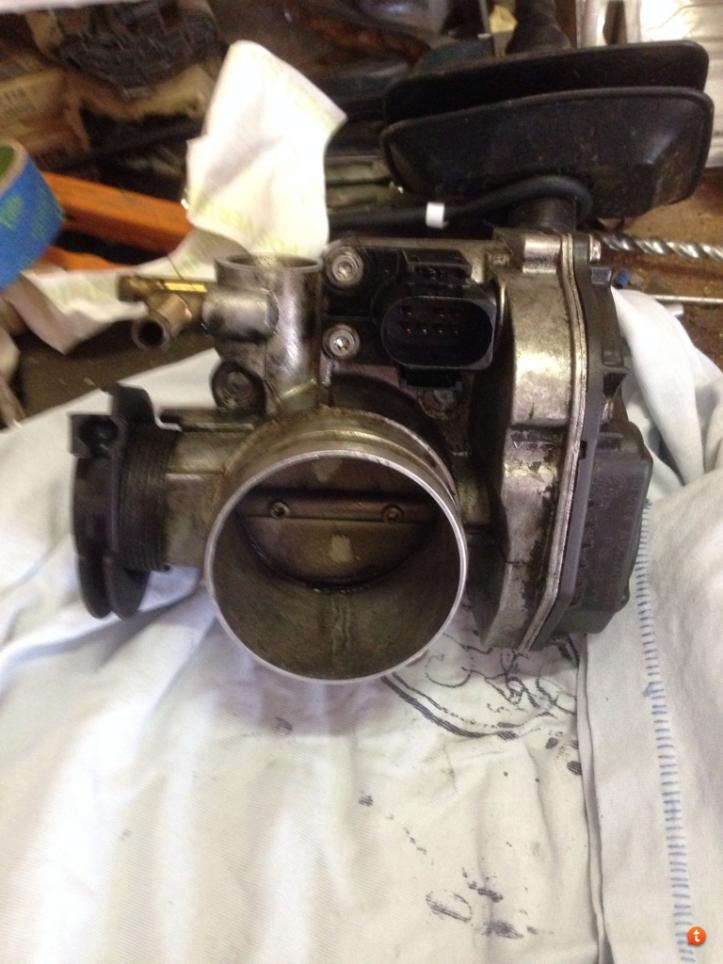

                  Googled it and I feel like an idiot for not knowing what it was but I've found a DIY on cleaning out the throttle body so I'm going to give it a go tomorrow arvo and see if she'll start. I didn't want to start pulling everything apart before I even got it back on the road...and rego's out in 3 months so wanted to spend it driving ha
                    Got the throttle body out ready for cleaning, everywhere I've searched says they've used throttle body cleaner or something, would warm/hot water be a good cleaner without damaging anything?
                      Does water attack oil?
                      Buy some $3 degreaser from supercheap or a splash of petrol.
                      Gavin
                        Don't have a way of getting out of the house at the moment so luckily I found a little bit of petrol in the bottom of the jerry can, thanks gav
