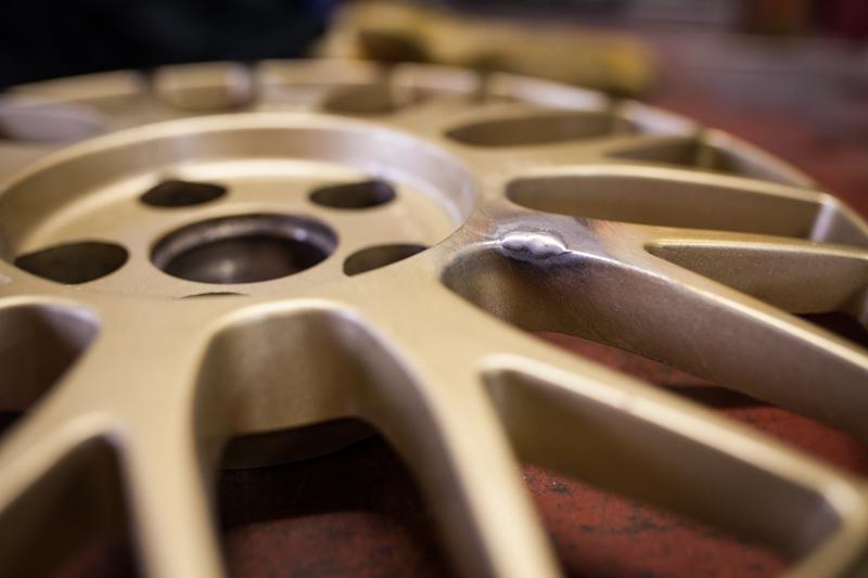

        Anyway picked up the centres from the machinist. Had him machine the centre bores out to 57.1mm and also weld up a pretty large chunk taken out of the face.
        Have filed most of that down now but haven't got any photos of it yet.

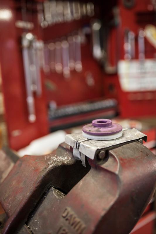

        Also had these 3mm teflon spacers made up for my front camber plates. Should stop the irritating spring bind!
        • #94
          Keen to see how those spacers go!
