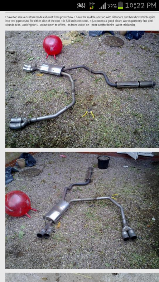

        Seen a couple of these on golfgti forum, milltek system for dual tip bar like r32 like im going for. Duno how much but looks good
