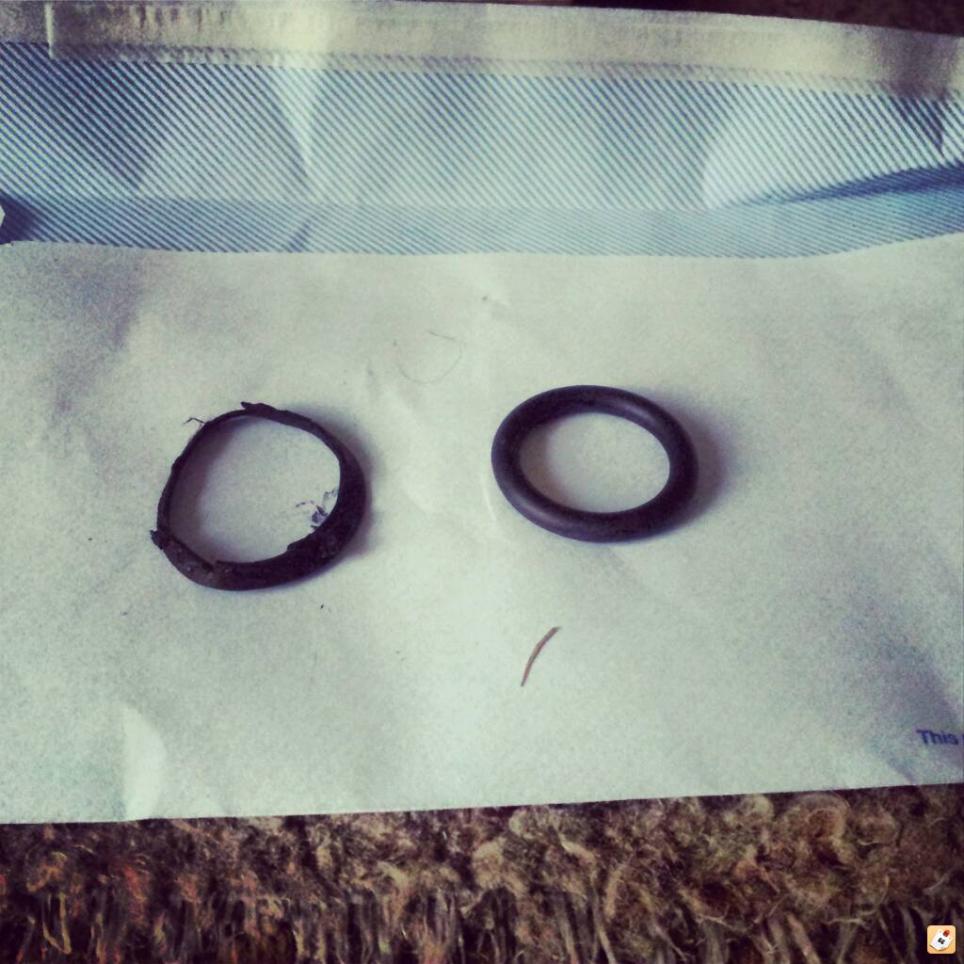

                          So a lack of coolant in the car this morning resulted in a quick top up which saw everything leaking on the floor
                          After looking closer we located the leak to be coming from the coolant sensor.
                          Pulled battery out and disconnected several coolant hoses to get to the sensor.
                          Turns out the o ring for the sensor had completely perished. Old v new below
                          Big thanks to good friend Erin for the help and to Adam from VA Garage yet again for ducking to his workshop to hook me up with some parts.

                              What caused it to perish Corey? I'd be guessing it's normal wear and tear.

                                Just age and heat Id assume.. The sensor is in a tight spot so I highly doubt it gets checked regularly. Just worth while keeping an eye on or replacing if you do a full fluid flush
