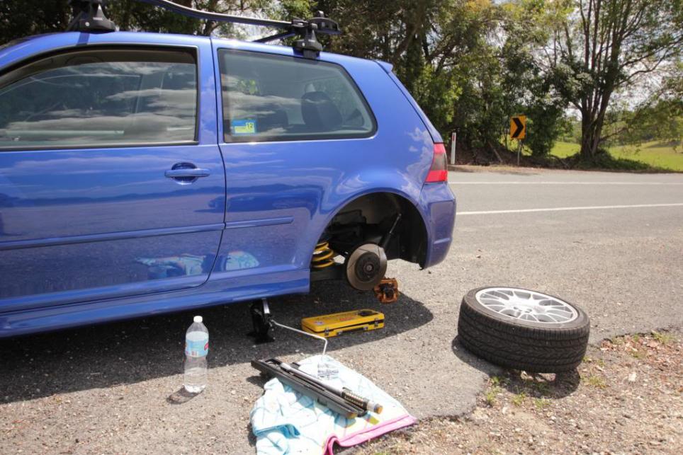

                What caused the rear brake pad to fly out the back of the car? At least in this instance, no one was hurt because of this.
                Wish you happy motoring this summer
                • #38
                  The Caliper carrier bolts came off the car, no idea how as I torqued them up myself! When we hit the bump in the road, I suspect that it caused the caliper to jump out of position and the inside pad then flew out the back. The outside pad twisted and locked the caliper between the wheel and rotor causing the caliper to drag its 455 on the inside of the rim until we pulled over..
                  Obvious problem is obvious.
