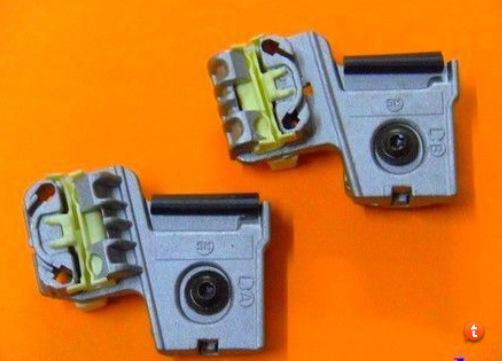

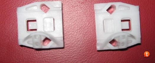

                  So finally got around to taking off the door skin to find one of the clips broken. So.. Does anyone know if the metal ones on eBay will work? As the clips currently on my car look different (plastic).
                  Metal clips:
                  Plastic clips (current):
                  • #24
                    You want the metal ones.
                    The issue is the plastic ones perish over time and break. Same with the plastic water pumps. The solution is to get metal.
                    Dealers wont stock the plastic as they have been superceded.

                      Cheers mate. Wasn't sure because they looked different
                        hey mate, im not too sure if the original cables from the plastic clips will fit inside the metal clips (from memory).
                        2003 MK4 Golf 2.Slow (a.k.a the money hole) - 18' Lenso Type M wheels so far
                        • #27
                          Ah k thanks. Might as well get the full kit then.
