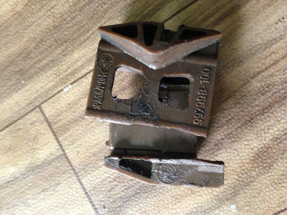

thanks for that DIY. i managed to open the metal plate and figured out what the problem is. this little peice of plastic broke -__-Originally posted by JustCruisn View PostShould be a lot of 10mm bolts holding the metal plate inside the door.

so apparently i cant buy just the clip on its own at the VW dealership but instead i have to buy the whole kit for $230. soooooooo i went on ebay and bought the whole kit for less than $50 with metal clips instead of plastic
