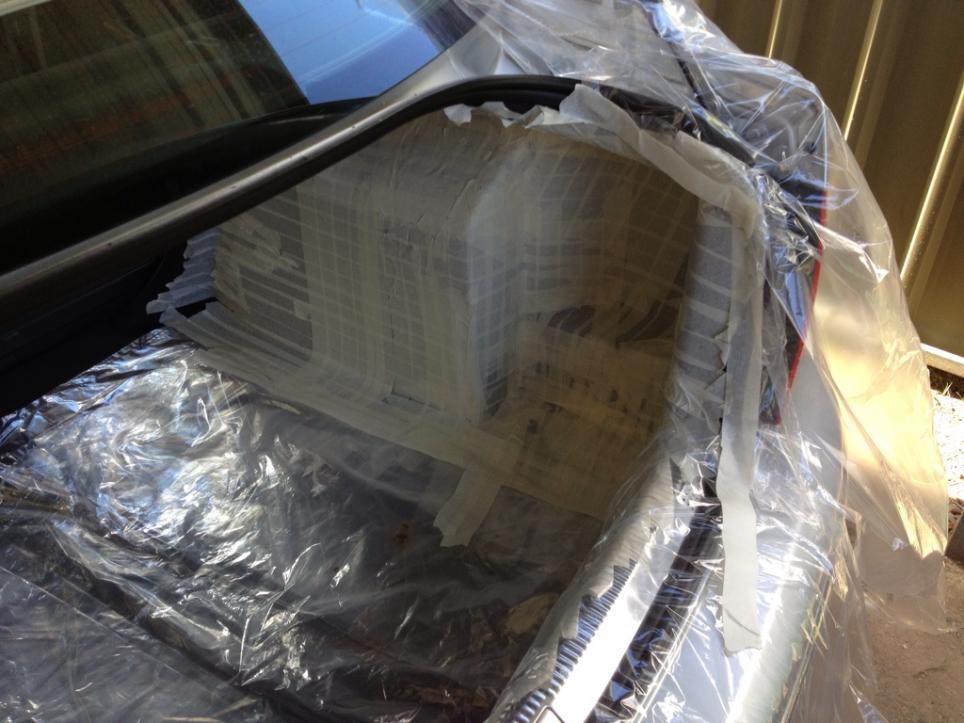

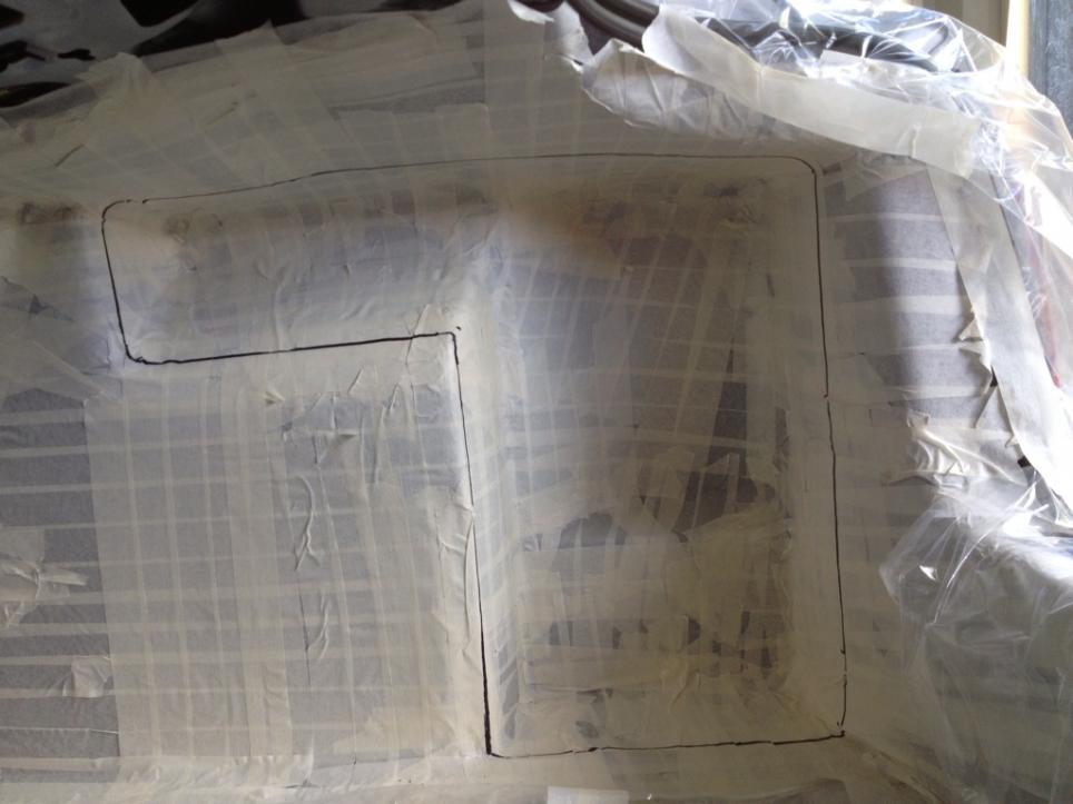

    Ok first thing first. you cannot spend enough time taping up the area to glass, and plastic sheet the boot. Trust me you DONT want to get this **** on your carpet.

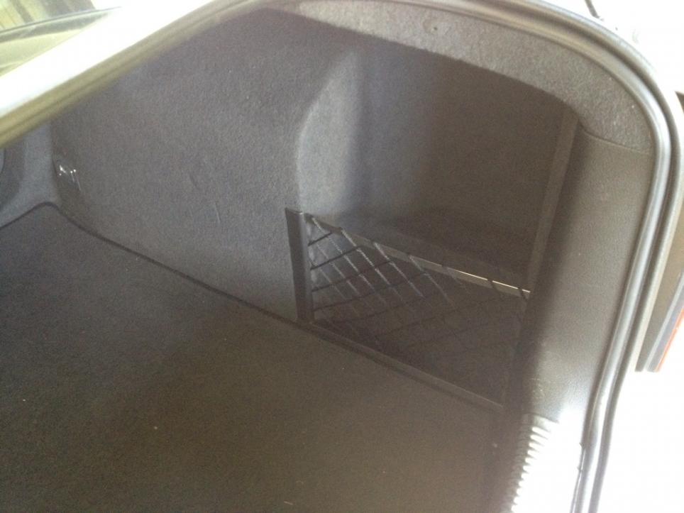

    Remove the cargo netting thing. (tried to carefully remove without breaking, but in the end proved impossible.)
    I found that putting the rear seats down and physicaly getting into the boot was the easiest way to make sure i was getting access to all the hard to reach bits,
    Mark roughly the shape of the sub
    VERY IMPORTANT STEP Lightly spray some oil onto area you are going to be woring on - i used some low calorie olive oil as i said a VERY light spray. Prep by cutting your fg into strips (2inch x10) this mkes life alot easier when applying the FG

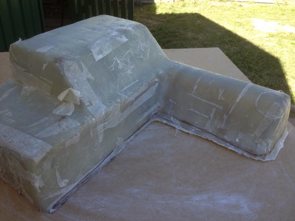

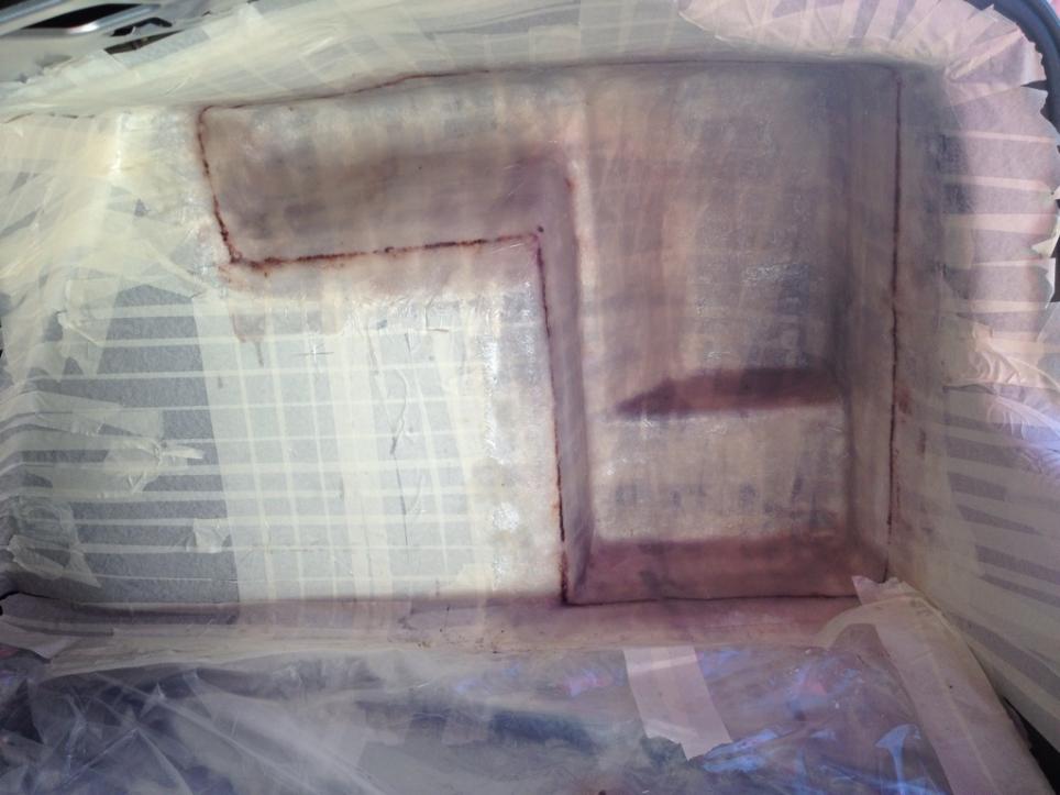

    So start building your layers of FG up, use your paintbrush to 'stipple' the resin into the FG, mking sure you remove all the bubbles.
    Make sure you bring your FG at least 2-3 inches over the line (find out later why)

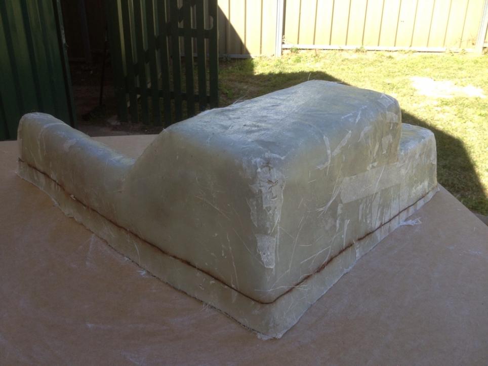

    Once you have 3 layers or FG mat (with 24 hours of drying between coats) you can pull the mould from the car. This wasnt too easy but after 10 mins or so of freeing off and pulling it came away.

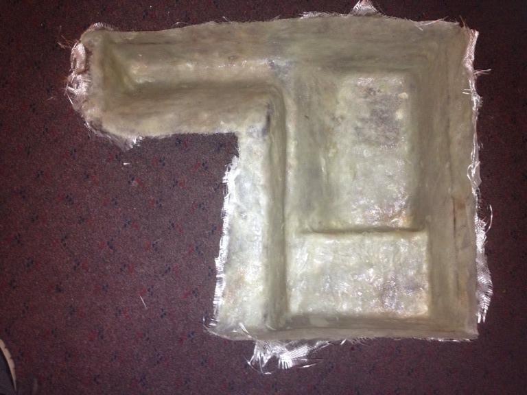

    The next thing i did was use a multi tool to clean up the inside, to mke it as neat as poss. I then put 2 layers of FG Cloth as a final coat.
    After this it came to the point i was dreading. The cutting of the FG. It became apparent that the lines i had origonaly drawn were a mile out (i was glad i had gone a few inches over the line.)

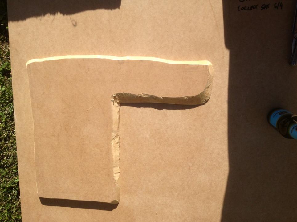

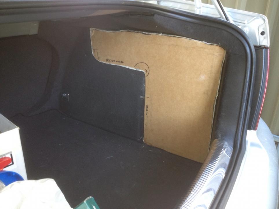

    Mark round the sub then trim to suit
    Test fit

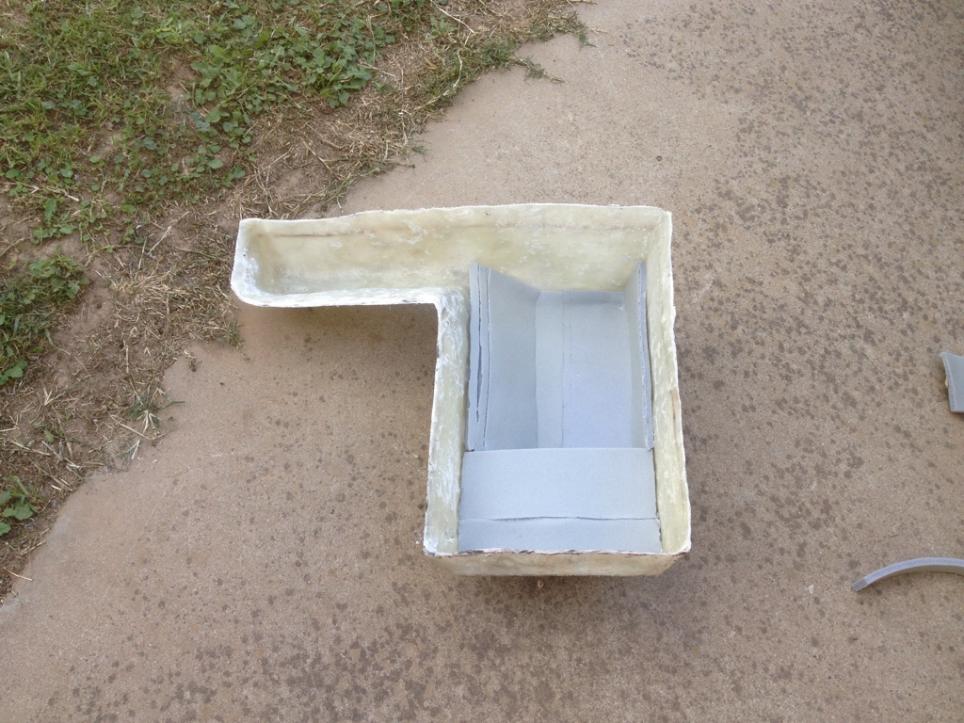

    decided to fit som 8mm foam to the rear of the enclosure to minimise vibrations

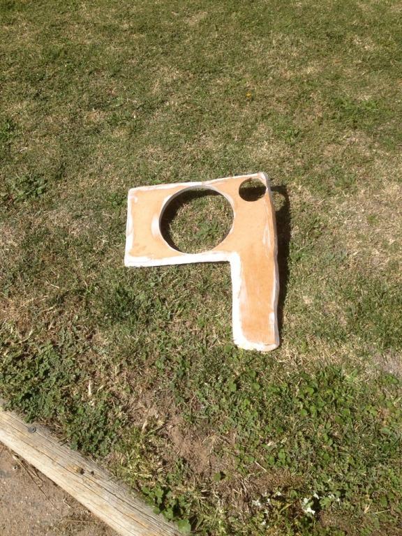

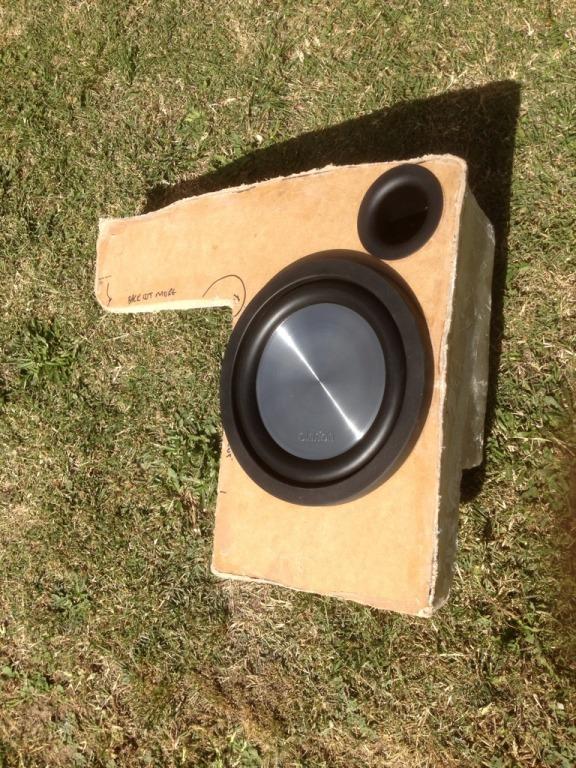

    Mark out and cut speaker and port holes. I then pva glued all cut edges.
    Got some proper audio speaker filler from jaycar
    At this point i ran a thin bead of no nails adhesive round the inside of the enclosure and round the edge of the mdf, sat in place and used a scraper to fill in any gaps. left for 72 hours to dry (it actually to that long to go rock hard)

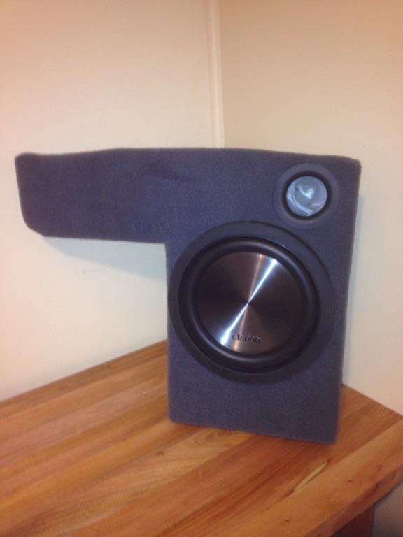

    Rough build time 25hours

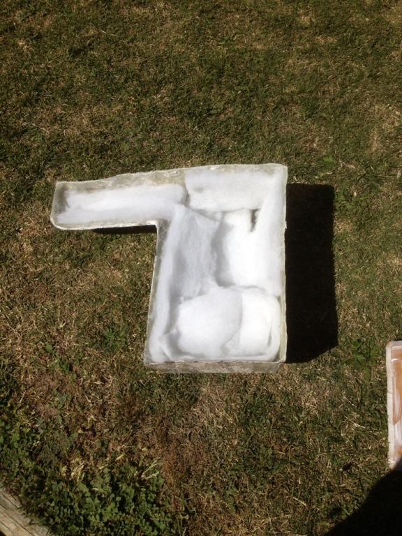

                              Nice build of the sub box,
                              What I could recommend to improve on the low end for this box or any future box.
                              Don't worry about the dacron fill at all. Instead, Use sound deadening, to seal the wood face to rear and any other possible leaks.
                              Then do exactly what you did with your 6-8mm rubber/pvc sheets. that is al you need.
