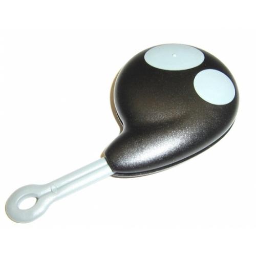

    My mid '99 Golf GTI came with a goofy looking Cobra 7777 keyless entry remote, exactly like this one:
    I changed the battery, and now it doesn't work. Apparently I left the battery out for too long and the remote has un-programmed itself. The LED on the remote comes on when I hit the button, but no lock-unlock. I've Googled the universal programming procedures for the Cobra 7777 and none of them have worked.
    Does anyone else have this system? Does anyone know where I might find the actual module in the car that the remote communicates with? If I can identify the actual system I might be able to find the right info. Cheers.

      This is the Votex keyless upgrage they made exclusively for VW , the module was normally fitted inside the drivers door and ustilised the green and grey central locking wires coming from the lock module. Any we fitted went there, made it heaps easy to fit and terminate

        Cheers mate. Found it - behind the panels under the steering column.
        For future reference, it says "Votex Gmbh, 4M1046V1C, e3, 12V Type 1046, Delta Elettronica" and it's cable tied just below the instrument cluster. View from below:
        Also I think I've found the user manual, in case anyone is looking for it in future: Link, & alternate.
        It looks like a dealer install. I guess this was the solution for pre-CANBUS cars.

            Interesting. The reprogramming process described in the manual worked, but it only when I turned the ignition on.
            Anyway, I'm glad to have my remote back! No more getting soaked in the rain while fumbling with the key.
