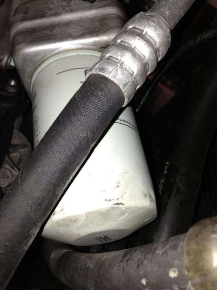

    Just wondering if there was a special way to remove the oil filter as it seems impossible to remove by twisting it.
    Here's a photo
    Thanks for any input guys
    Multigrips .
    And the oil filter fitted is the wrong one !
    Bug_racer supports the rebellion of the euro revolution
      Help on removing oil filter
      Originally posted by Bug_racer View Post
      Multigrips .
      Multigrips? Yeah this one was fitted on by the previous owner. Just got back from VW with an OEM oil filter but can't get this one off!
        You need a "strap wrench". The strap wraps around the filter body and the handle then twists it off. Any auto accessory shop should have them. Best of all, you could ask if you could try is to see if it would fit.
        Now there is an "Irish" version, however it gets messy. Basically, you stab it with a screwdriver and get it off that way. It is a last resort, and sometimes, even that can have issues.

              Or pierce it sideways with a long bladed screwdriver and use the leverage to crack it.
                  If you do this makesure
                  You puncture through towards the end, away from the engine, use a posidrive/phillips head screwdriver.
                  Punch right through and turn.
                  Also when you put the new one on , put a thin film of oil around the sealing rubber ring before you screw on and tighten

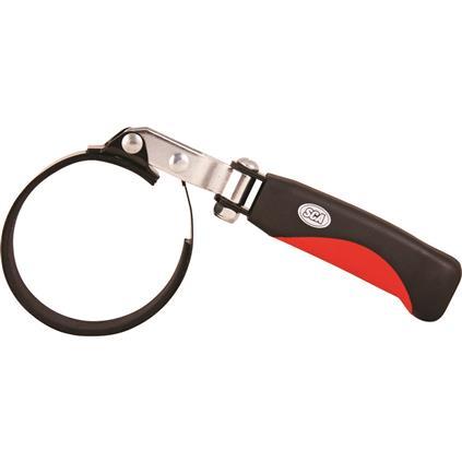

                      SuperCheap sell these which are really good
                      2012.1 Skoda Octavia VRS DSG Wagon - Carbonio cold air intake and pipe - HPA Motorsports BBK 355mm rotors 6 pot calipers
                      APR Stage II ECU - APR 3" exhaust down pipe & high flow catalyst
                      APR/HP Roll bars - Eibach springs and Bilstien shocks
                      Supaloy lower control arms - Enkei 18*8 Wheels
                        I don't think it will offer the leverage required.
                        '07 Transporter 1.9 TDI
                        '01 Beetle 2.0
                          Yep, that's the one I got. Didn't budge, also used a leather belt (found it to be more useful) but still wouldn't budge
