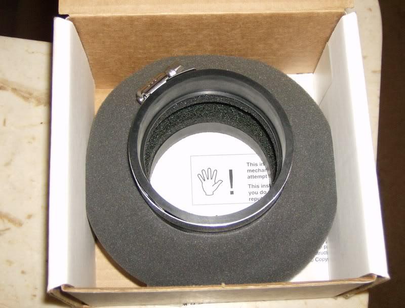

Ok guys I've been reading a few of the CAI Threads and it seems everyone is worried about the water in the engine thing, which is understandable. I too was worried till i did some research. There's a thing called a bypass valve most of the big manufacturers have these. i personally have an AEM one.
It's the grey foam thing near my MAF.
The way it works is that if your pod should suck up water the vacum would open up the rubber flaps on the bypass valve thus sucking in air from the engine bay till the water drops out of the Intake and normal operation can commense. The whole mechanics of it can be found here as well as an awesome test involving sumerging an entire pod filter in water.
http://www.sportcompactcarweb.com/te...lve/index.html
K&N does something called a dry charger which is something that goes around the actual filter. I've been using the Bypass valve and a mate has been using the K&N dry charger and neither one of us has had any issues what so ever with regards to spluttering/ jerking or anything else out of the ordinary when it comes to driving in the wet or puddles.
I hope this helped dispel some of the concerns or questions you had with CAI kits and water
