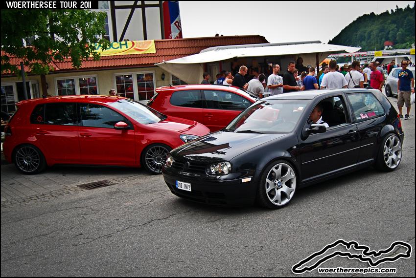

Thats a 19x10et32 with 2.5deg of camber and a 235/35 tyre
you may or not have more room due to camber/4mo suspension setup, and may or may not have a variation in offset due to wide track/different brakes.
from what iv noticed there is a difference in 4mo and FWD mk4s in relation to the wheel track. so most of the info/photos above are invalid as they are FWD cars...
plus your dealing with serious wheels, so at the end of the day, each car is different by enough to make or break the fitment.
