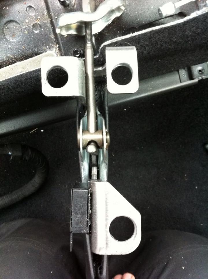

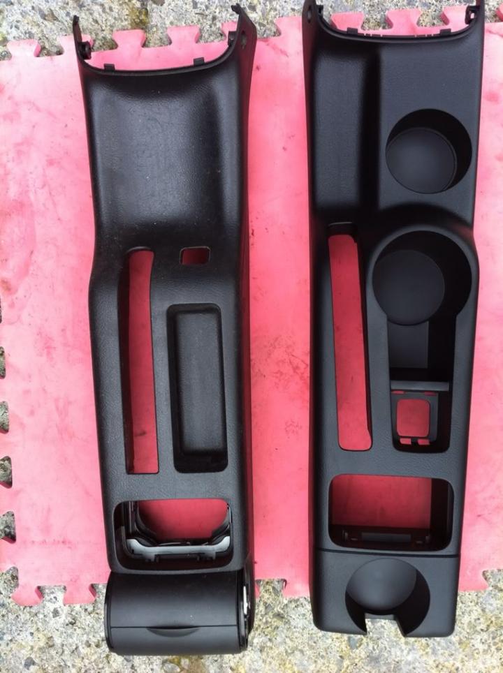

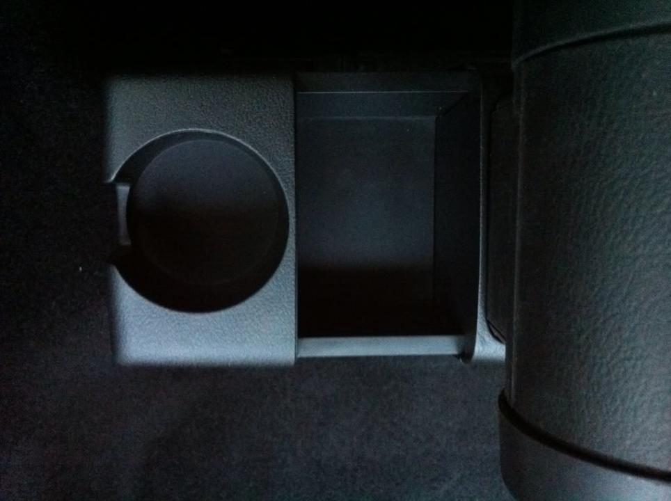

Eventually got round to fitting this, it he handbrake sits at a different angle so when it's removed just drill out the mounting holes larger.

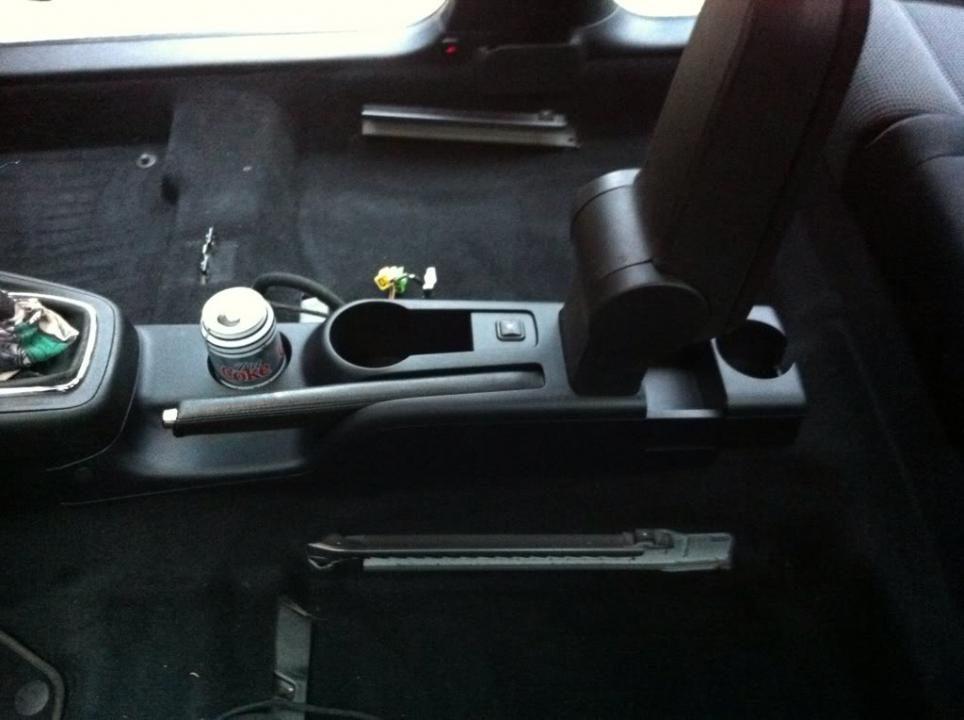

And stick it all back together, I removed the seats to make it a bit easier.
And part no's for the bits

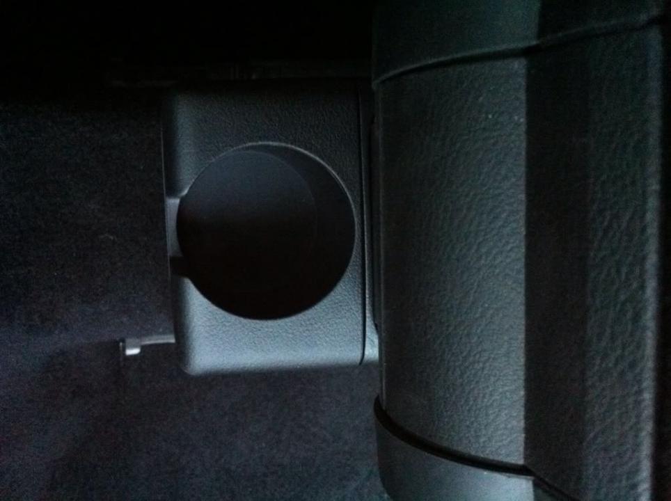

One is for the console and one is for the fuel flap release button , the U.S has it in the drivers door.

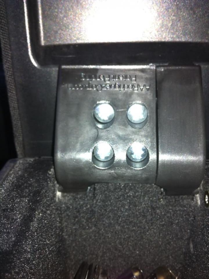

And a repair kit for the broken hinge on the centre armrest

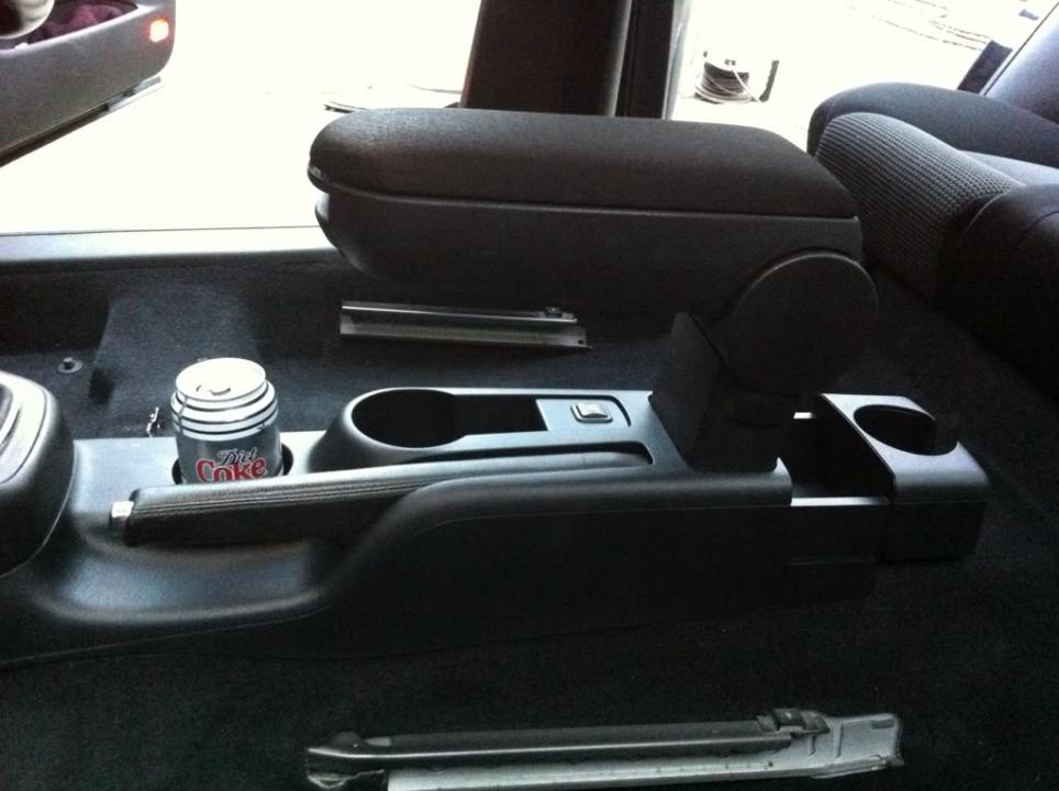

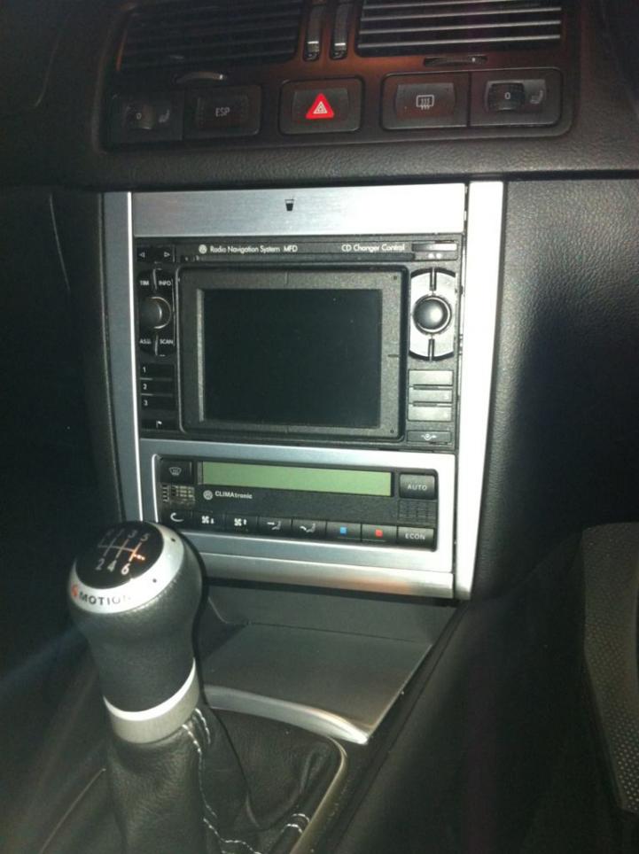

Mate that centre console looks good. Nice change getting rid of that stupid ashtray which always break. One thing I suggest is you get rid of that ugly wood grain go for aluminum finish. Here's a pic of mine
Apart from that lovin the build mate looking sweet!!!

Hey mate what kind of centre console is that from? looks awesome!
Loving your work mate ! question about the W8 light mod .. did it fit with the existing wiring or did you have to get a different harness for it ?VW BORA 2003 V6 4Motion
That console will fit the mk4 Golf - there's a few people with them locally. ECS sells something similar without the fuel release section as the US spec was slightly different. I think they were introduced in later years of the mk4 here. To fit it you'll need to change the angle of your handbrake slightly as mentioned in the thread.
