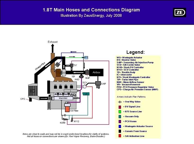

                  Sorry mate, not clear. There are 3 components you seem to be playing with: N249, N75 and diverter / bov.
                  The N75 regulates the wastegate and it sits near the diverter. The diverter is the larger device and it provides a route for the unwanted boost to escape when changing gears, etc. The boosted air is routed post compressor, pre intercooler back into the intake (post map, pre compressor), so it should be maintained as the ECU is expecting this airflow. The N249 can be bypassed by looping the vac in to the diverter line out. A new Vac line should be run from the manifold to the diverter vac in nipple. The intake manifold produces vacum when off throttle, this vacum is used to open the diverter whilst the N75 opens the wastegate.
                  Make sense? If you are doing anything else, you may be causing the 'limp mode', limiting boost, etc.
                  If you don't have a N75 at all, how will the wastegate open? If you use a MBC, the ECU may throw a fit as the logged air readings / boost will be outside the expected parameters and MAY throw you into limp.
                  Does this borrowed pic look about right?
