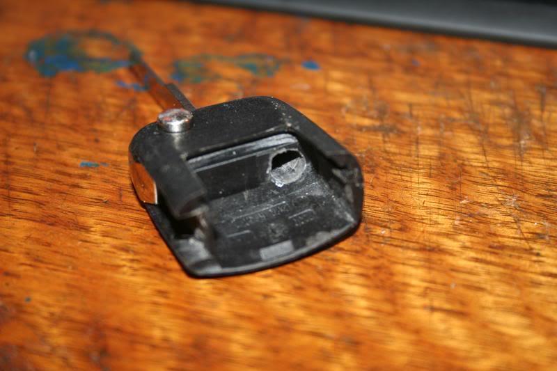

            I have a Mk4 Key I bought and modded to work in a Mk3. The short version is that I drilled a hole on the inside to drop my immobiliser chip (which has since been removed). The electronics still work, the immobiliser chip?? Who knows?
            I also have a number of blanks from an alterative (generic) switchblade setup that *should* fit into the key. If your interested I can drag the lot out have make sure it all fits together??
            Plan B (if my chip is dead): you can probably get your local locksmith to clone your current working key, then pull the chip out of that and stick it into my setup with an appropriately cut blank).

                      The mk4 key has a recess for the transponder, so you might not have needed to drill a hole. That said, the mk3 chip might be larger.
