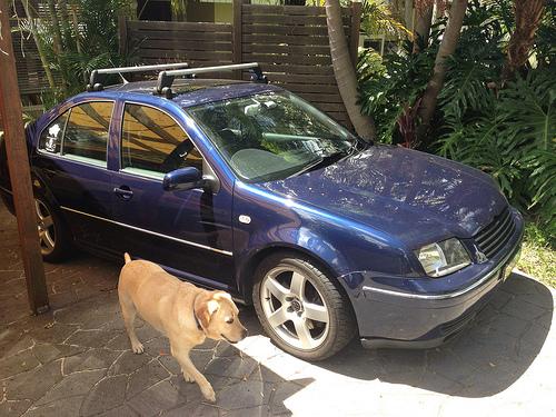

But, got some OEM roof racks on the weekend;
Beware the Dubhound.

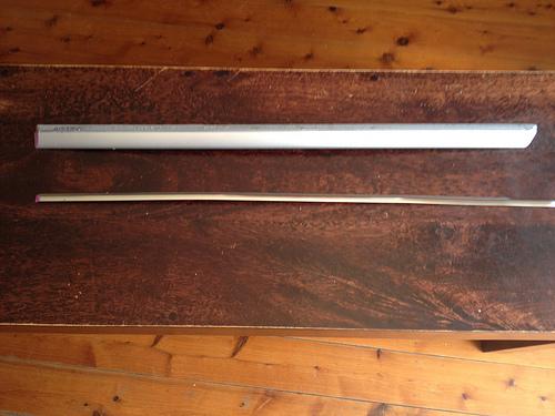

Also, finally got a new side strip

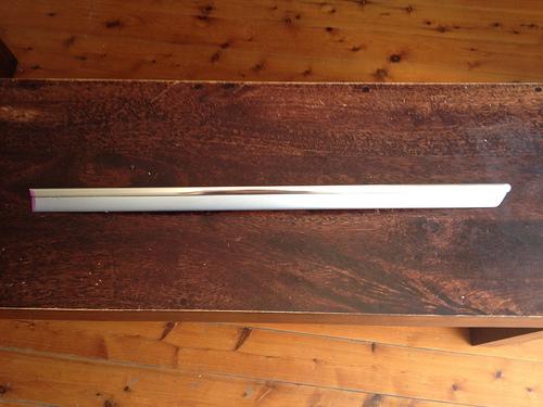

Which, with gentle persuassion, becomes
Almost 3 years I've had my Bora and that bloody missing strip on LHR door is *finally* going to get fixed.

Racks were from that man 2 posts up ^

The side strip was from a wrecker on eBay for $70 delivered. I don't know, but things seem a lot cheaper this year.
