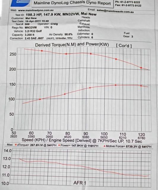

                          Attended the dyno day in Sydney yesterday.
                          Best run was 148 awkw, exceeded my expectation for sure.

                                And here is the graph:
