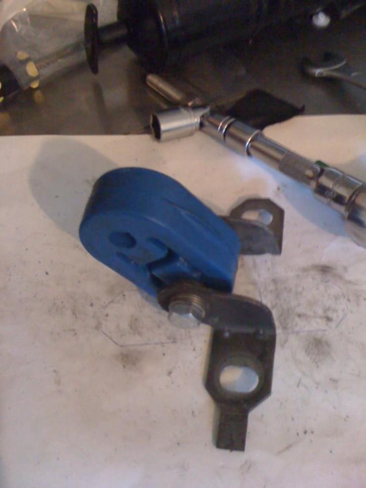

Following that howto today, i made up the following exhaust hanger using a Cusco Polyurethane hanger bought off good old ebay ($25), and the bracket from my existing hanger. (I actually bought a fresh stock hanger just in case things didn't work out.
The new hanger has pulled the exhaust up quite a bit. There's almost 2cms of clearance between the exhaust piping and cross member now, and the exhaust isn't moving/bouncing about at all... Overall i'm very happy.
