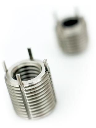

                  Don't Helicoil it. They're terrible. I'd Keysert it or something similar. Use Loctite High Temperature thread sealant with Teflon on the keysert to stop the oil wicking out through the outer thread.
                  It's going to cost a little bit to get that done because of the diameter of the thread, but it's well worth going for a keysert/timesert etc. Helicoils are a last resort in my opinion and not a good idea in aluminium.
                  Keysert...
                  Timesert..
