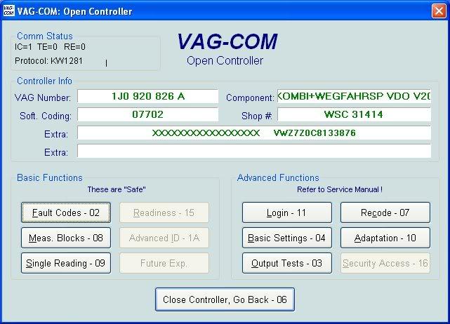

                      I got my Vag-Com Cable working with the car and I quized 17-Instruments and this is what I got;
                      From the looks of it, its a VDO type cluster. Anyone confirm this?
