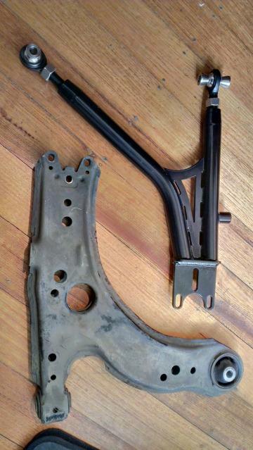

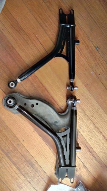

  • Thanks to Peter for the borrow of the existing arms, not sure mine are straight enought to be used as a template anymore

        Those control arms look yummy!
        • Well my house mates dog decided to hijack two of the rubber boots from the new arms from my desk (I only found one ) so thats put that on hold until a new one arrives.

                So IDF adjustable control arms went in after some fluffing around with replacing dust covers (house mates dog ate/stole them) and then managing to cross thread one of the arms due to it still being filled with beads from blasting or something) much thanks to Waterboy, his dad, and his dads mates for coming to the rescue as usual!
                after the 30 odd mm of toe out (those lowered car problems) was pulled out I had an extra deg of camber added, for those not fimilar with these arms it actually makes the wheel sit out even further, creating a massive wide track set-up on the front of my car compared to the rear.
                Im happy with the arms, while it removes the comfort of the bush I had become accustom to driving around with dead bushes and control arms resting on the subframe, so if anything comfort increased by adding these.
