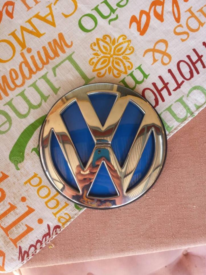

            • Pulled my boot badge apart and painted it , just need to put it back together also can u bug just the sticky backing from vw for the badge ??
                  Looks great mate, just rip all that sticky stuff off and replace with some good quality, automotive double sided tape. I used 3m and it's yet to fall off

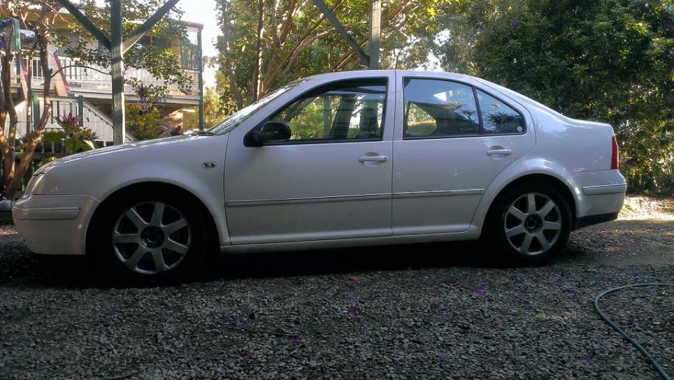

                    • I received a nice surprise in the mail today. Apparently Aus customs deemed my H&R coilovers to be worth less than $1000 despite my telling them i payed $1135 for them?
                      Not complaining at all. I was not expecting to see them for at least another week and was also expecting a bill for >$300 for the pleasure.
                      Installing them tomorrow afternoon/night

                          OK! Got the fronts done.
                          The passenger side strut did not want come out without some persuasion but both sides are in now. I did not make any height adjustments before putting them in but it appears to be around an inch lower than it previously was.
                          Got the rear jacked up and started by removing the shock but thats as far as i got before i packed it in for the night.
                          TRIPLE EDIT: All done!
                          All up it took around 5 1/2 hours. The rears only took about 90 minutes to get done.
                          Silly (lack of) H&R documentation was not clear on trimming the rear bump stops or not though or to use the silicone wax lube stuff on them either. Either way, i have what seems to be an obligatory right rear knock? Checked the rear trailing arms and they were tight as a you know what so i don't think it is them?
                          Anyway. Around 1" lower front and 3/4" lower at the rear. Slight toe in noticeable on the rear and very slight negative camber on the front. The front does not worry me but the rear tires will not be liking the toe in.
                          FINAL EDIT: Picture
