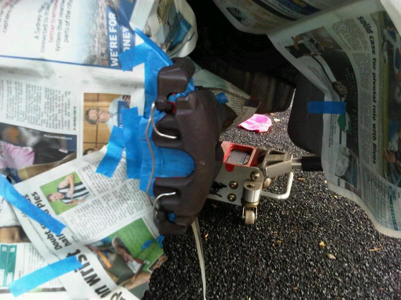

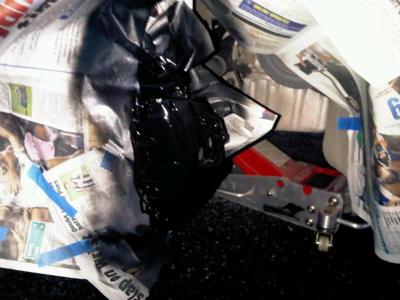

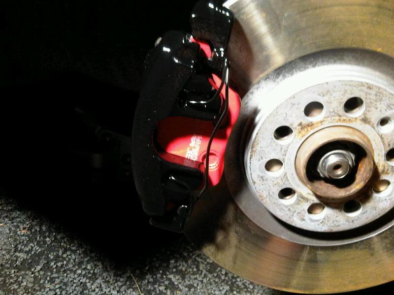

Ok, seemed like a big few days till i realised how little i've actually done. Though, for a first-timer on most of these jobs I reckon i've done ok - haven't broken anything or stuffed anything up.

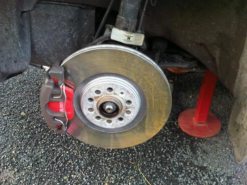

Front calipers before:-
Masked up:-
First coat:-

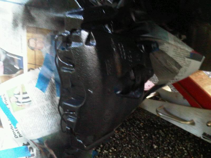

4th coat:-
Unmasked and done:-

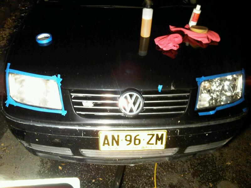

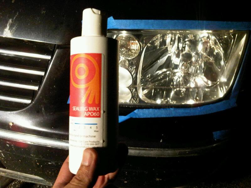

Then decided to do my annual headlight clean up (left not done, right done):-
Then sealed but not sure its the beat sealant:-

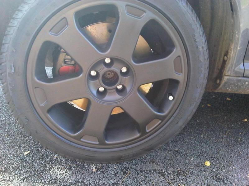

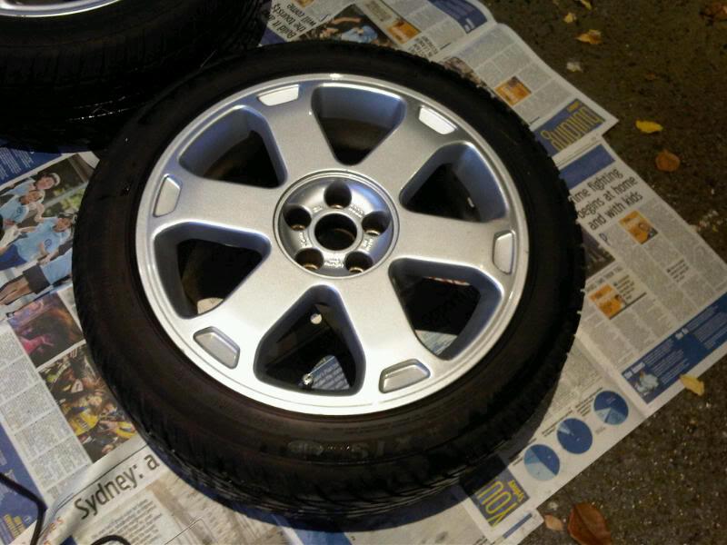

Rims prior:-
Rims after:-
Nice work on the rims, I was thinking of doing mine with a gunmetal grey as well, did you put the tyres off or do them in situ ?

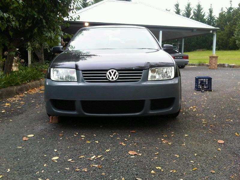

Today's progress, car is now back on all 4 paws, and with a new nose too. More to come, keep watching
r32 front bora <3

Bowser bonnet badless grill. Oooh yeah
Im liking the r32 bumper.
Hey Garryo degrease your rims and tyres to remove any tyre shine (silicone) wipe your tyre with thinners wet sand the rims dry em and go around your tyre with masking tape and paper. Spray the rim unmask and your ready to roll again.
deflate the tyre if you can. Makes masking easier and easier to get right in that edge so it will all be covered.
Also use P800 wet sandpaper, make sure the whole surface looks satin with no shiny bits. Then you know its properly rubbed

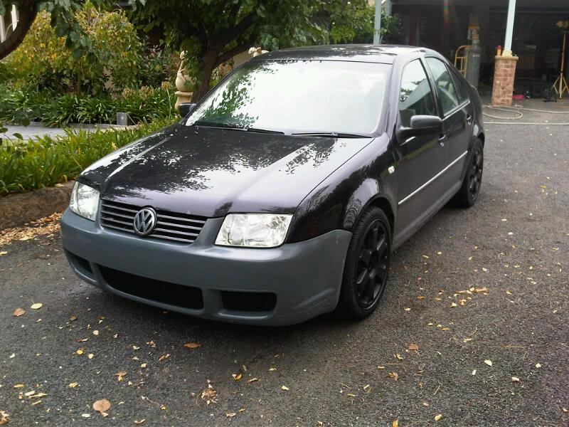

she badly needs the skirts and rear bar fitted, then painted. Problem is the rear bar is cut out for GLD (i think) and not for a twin tip R32 exhaust setup. Needs a body shop for that.
