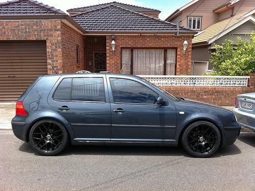

        I just got my new rims! Also, brand new Kumho KU31's all 'round...
        Now for the coilovers... I've booked in with the guys over at Camden GTI to get those installed, it's a bit of a trek from the east, but I think it'll be worth it from what I hear... so watch this space...
        PS - excuse very basic iPhone photos...
        im liking it! lowered right thats going to be awesome. I vote colourcoded trims later on. black wheels on that colour look nice!

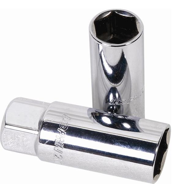

                    the way i got the tops undone was just with a Spark plug socket like this one
                    Stuck the allen key through it, Used a spanner on the spark plug socket. And on the allen key i found a small bit of tubing which i slipped over the end so i had enough force to hold it in place while i undid it with the spanner and spark plug socket.
                    Just find something that you can slide over the allen key to get a bit more leverage and you'll be right!

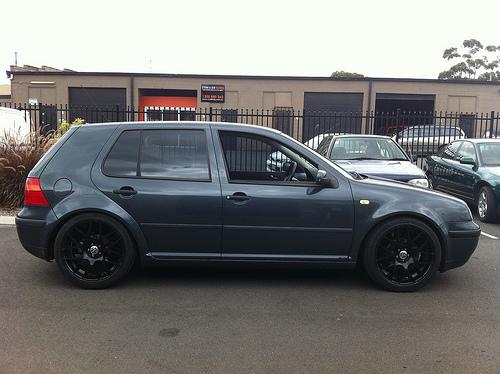

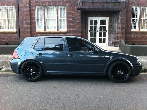

                          This is how it was after leaving Camden GTI, but I'm going to bring the rears up a little, to make the gaps more even. Also, finding the fronts handling bumps etc quite well, but the back is a little rigid, and this IS my daily drive. So, I'm off to do that. So happy already...
                          I'll go get another one right now, while the sun is good...
                          Dark Grey Mk4 Golf, 1.8T GTI conversion, APR stage 1, stock air intake, FMIC, 3" to 2.5" Exhaust, FK AK Street Coils, Black 18" (Avant Garde M310's ?), tinted tails, ...
                          • Bring the front down to match the rear looks good.
                            • Dark Grey Mk4 Golf, 1.8T GTI conversion, APR stage 1, stock air intake, FMIC, 3" to 2.5" Exhaust, FK AK Street Coils, Black 18" (Avant Garde M310's ?), tinted tails, ...
                              • Given that they will still settle a tiny bit, theres no need to lower them any more for a daily. I think you have the heights looking damn nice. You should definately be happy with that!
                                Have you checked lowest clearance point underneath by any chance?
