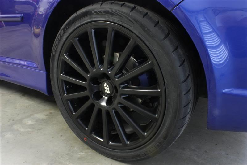

          • this ...

              • *Seriously* considering something similar on my Bora with the 17" Aristos - probably not quite black though, most likely is gunmetal or anthracite...

                        Nice.
                        Mate how much and where ya get your tyres ? I'm looking at some soon so if ya not mind me asking !!

                            I have found Tempe is the place for Khumo's... they must be keeping the Khumo empire afloat going by the amount they shift in time I was there. I scored a set of 225/45/17 for the Bora for 150 each, and before anyone starts the whole "tyre age" discussion, those tyres I got were build stamped approx 6 weeks before purchased. Like I said, they shift enough stock to turn over regularly.

                              I got a full set of KU31s for the Bora 16s for $125 fitted about a month ago.

                                Hey mate, got the Kumho KU36's from Tyrepower in Labrador for $270ea.
