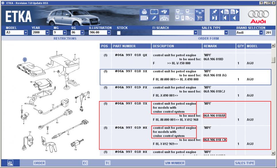

There are one thing you need to check with the ecu your buying. ETKA.
Il but since they mention 2 step and launch control dubster would assume right and it would be from a DBW car.
I'll check quickly for you anyway on etka.Last edited by Sirocco20348; 10-08-2019, 11:41 AM.
On this occasion it's completely wrong
The KC ecu comes from a 2003 Mexican VW beetle with a 6 speed auto hahaha
BDC reference is a 2ltr engine aswell...

Really? I bought an AQ stage 3 ecu from Lito with his turbo and it ran like **** with my 1.8t. Turns out my didn't have cruise but the ecu was meant for a car with cruise so Im assuming because mine was a converted 1.8t that was the issueOriginally posted by Sirocco20348 View PostThat's not 100% true, I actually swapped in an AQ ecu from an DBC Audi A3 1.8t and it ran fine.
No you have it round the wrong way.Originally posted by dubster99 View PostReally? I bought an AQ stage 3 ecu from Lito with his turbo and it ran like **** with my 1.8t. Turns out my didn't have cruise but the ecu was meant for a car with cruise so Im assuming because mine was a converted 1.8t that was the issue
The 06A 906 018 AQ ecu does NOT have cruise control. But it is an AGU ecu from an A3.
