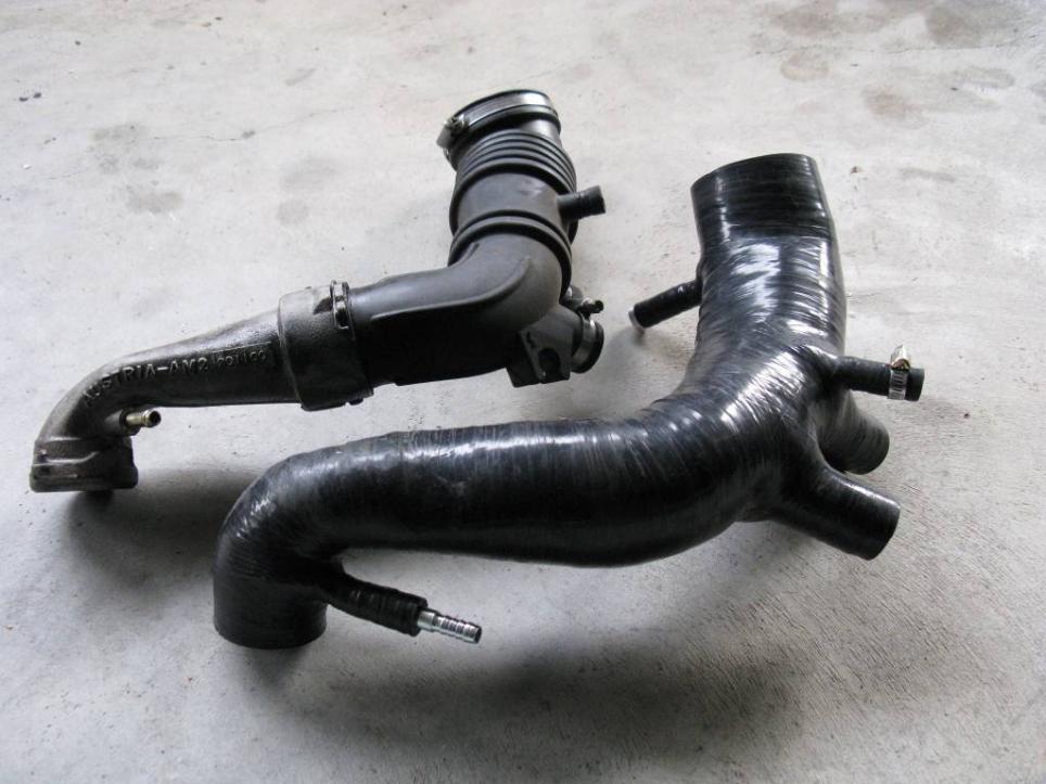

 - APR Turbo Inlet Pipe

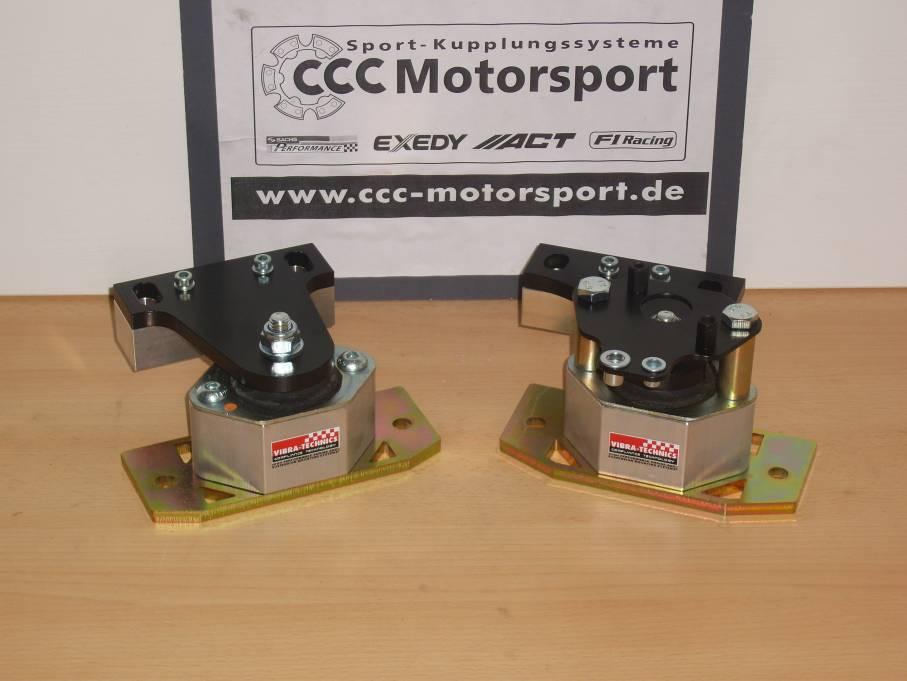

 - Vibra Technic Race Engine Mounts

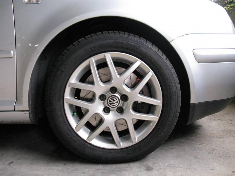

- 312mm DBA T3's
 - QFM A1RM Brake Pads

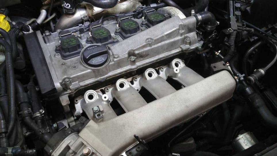

- Deatschwerks DW65V Fuel Pump
 - Bosch 4 bar Fuel Pressure Regulator
 - New Bosch 0280150464 injectors.

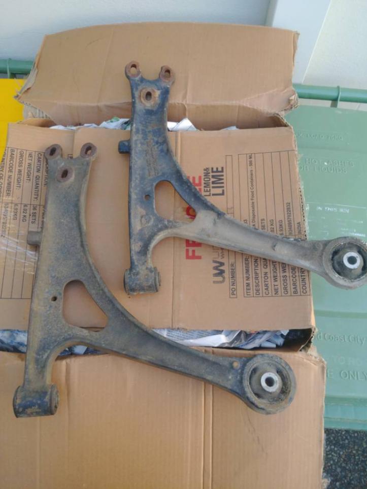

What is lying around waiting to go in:
- 256mm vented rotors with r32 rear calipers
 - Seat Cupra R rear axle beam bushes

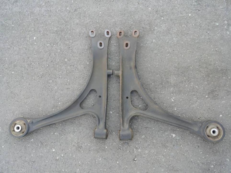

 - Audi TT Control Arms

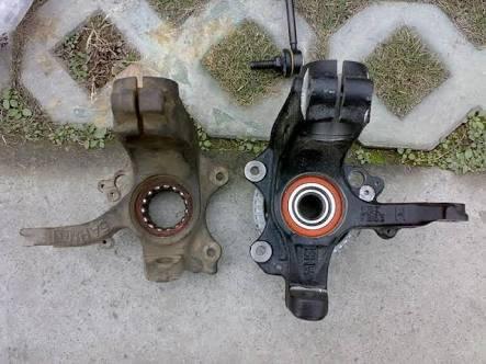

 - Audi TT Spindles
 - Audi TT Steering Rack
 - Semi solid subframe mounts

Since then I have been stock piling Audi TT parts to further improve the geometry of the car, but I need to upgrade my front struts to Audi TT variants because of the difference in sway bar end link connections. I have been in 2 minds whether to just get another set of B6 struts or replace with coilovers which is going away from what I was first trying to achieve.

Lately, I finished replacing/upgrading every bit of the cars fuelling to sort out various performance problems.
I had the Vibra Technics road engine mounts installed last week, which I think has been one of the most dramatic upgrades I have had while owning the car. I underestimated how much the engine moves when cornering with stock OEM mounts.
And I WILL have the Audi TT gear installed by the end of the year, which will allow for camber etc.
