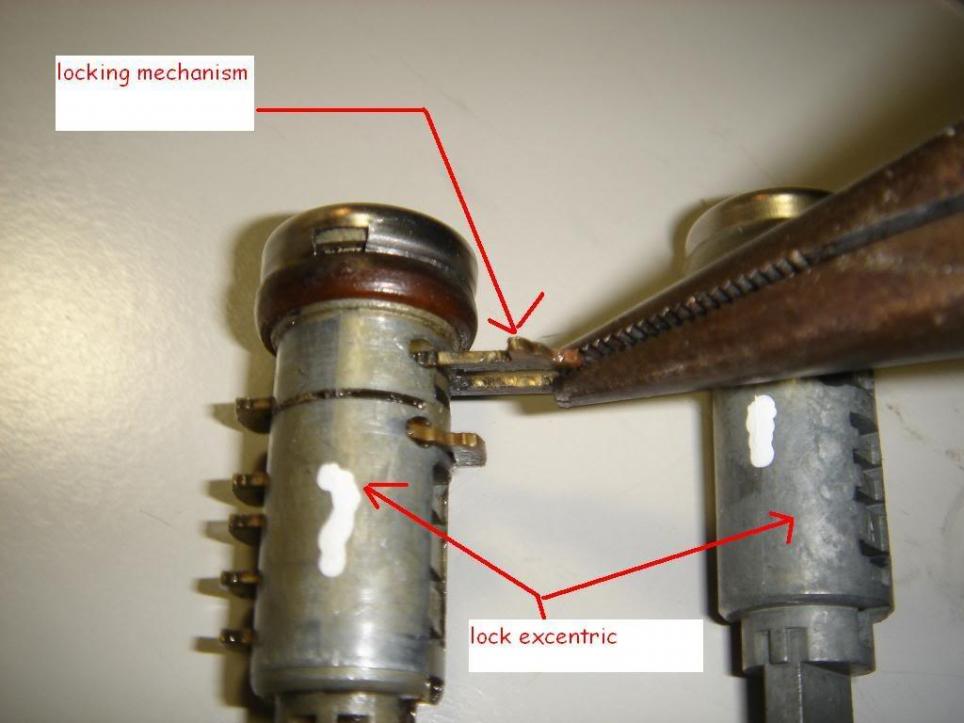

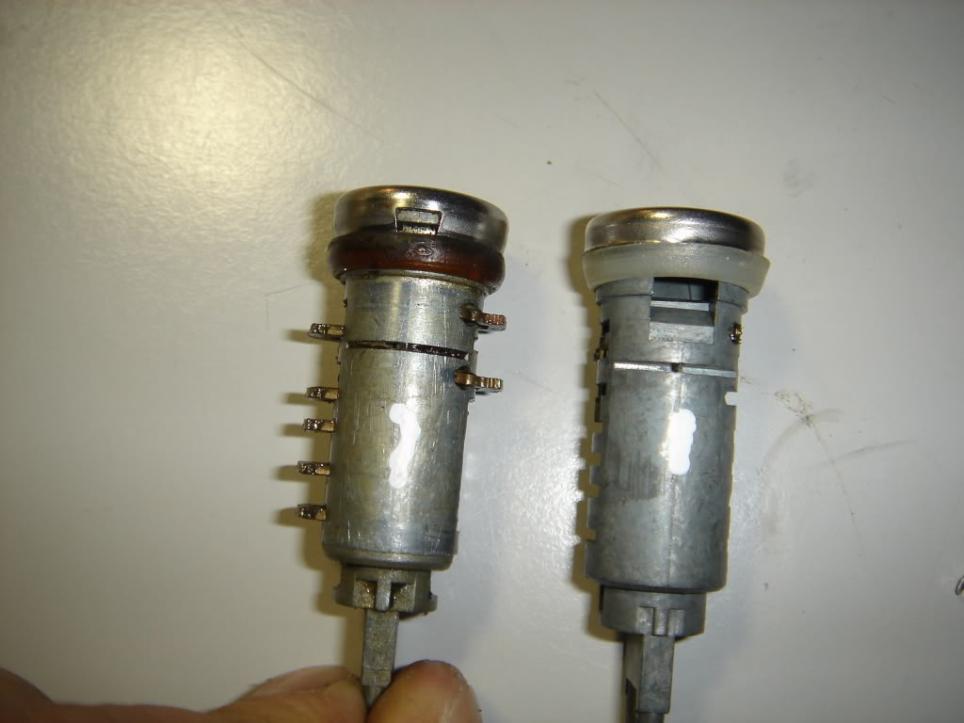

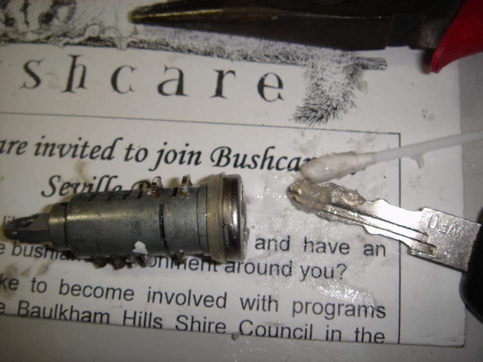

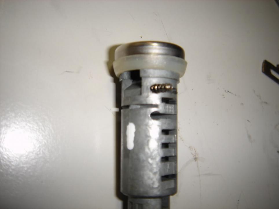

    Firstly, the locking mechinism on the lock excentric must be transplanted, this can easly done with a long nose pliers.

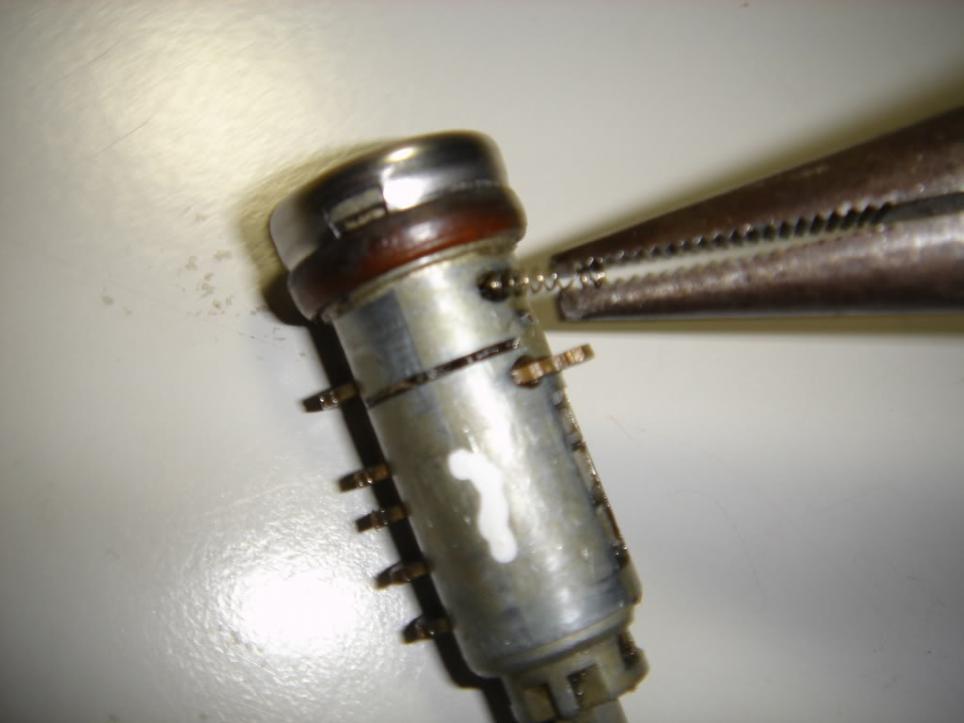

    Transplanting Spring from OLD
    To New

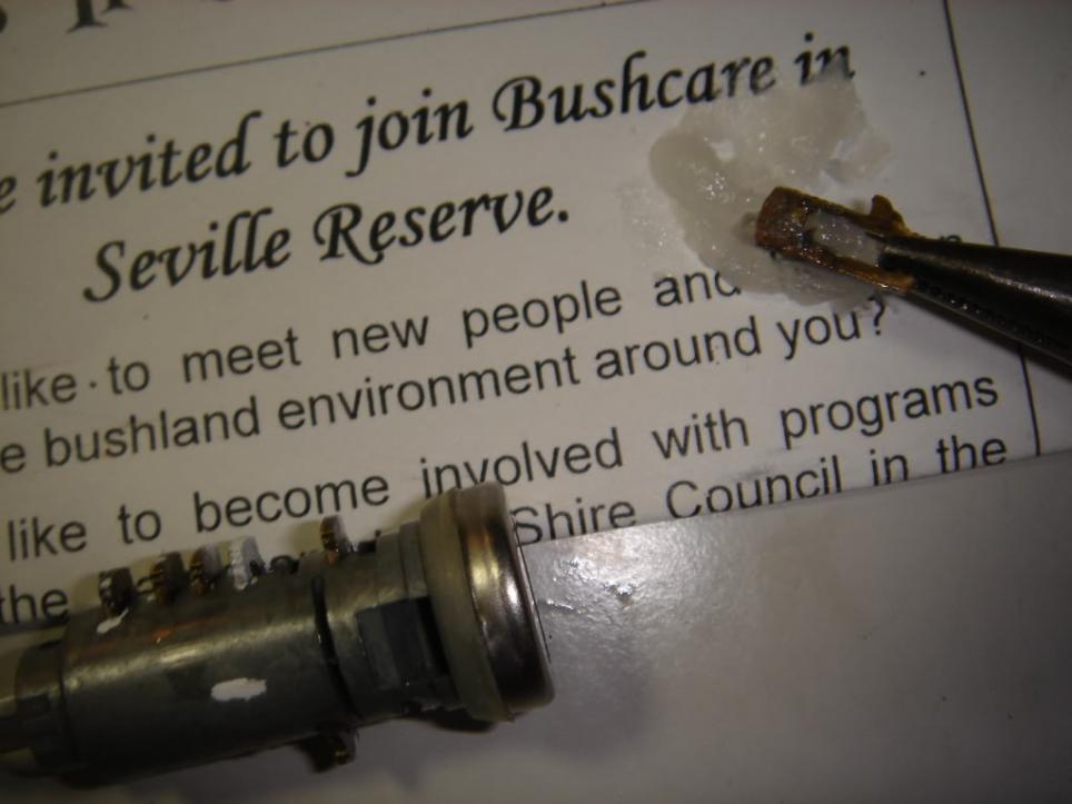

    Lubed up. Note: DO NOT USE WD-40!!!! Lock mechanism will violently eject when pulling key out. pain in the azz to line inorder again. Use Vaseline instead !!!!!
    Lube up key with vaseline and insert into key hole a few times.

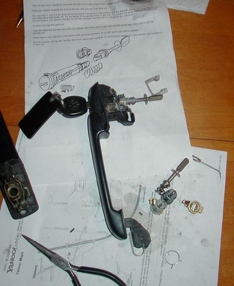

    Assemble lock as per picture. (Thanx vortex)

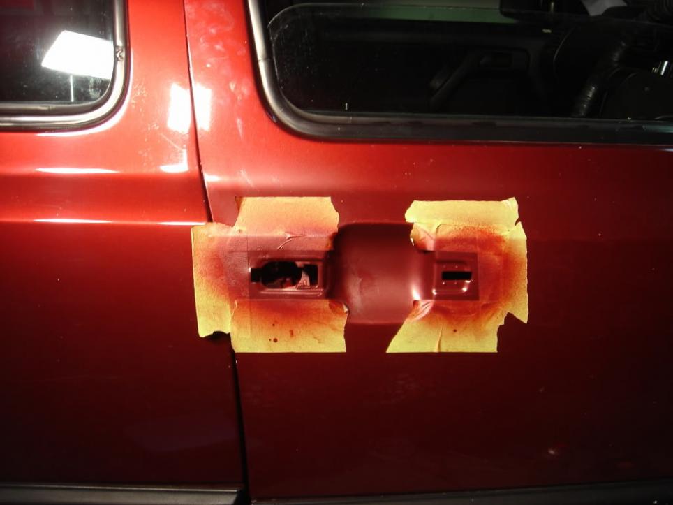

    Ghetto touch up.

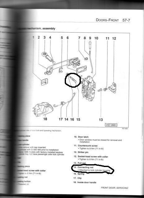

      The thing you have labelled as the lock eccentric is in fact the barrel.
      The lock eccentric, or connectiing rod is no 15 on that diagram. That is the bit that usually breaks and can be replaced on its own.
      Otherwise nice writeup.
        In about 2 minutes with a Seat part which is thicker and stronger... thanks Loon
