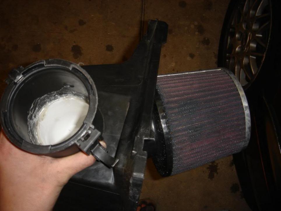

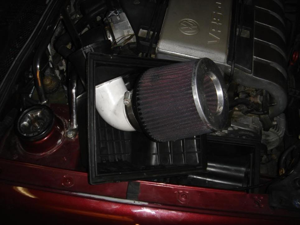

    Recently I have noticed my fuel consumption has dropped ,currently I avg 12.5L/100 daily, 17.5L/100 floored around the block and heavy traffic 22.5L/100
    I am not expecting this is going to give me much a difference, but a $6 Experiment wouldn;t hurt.

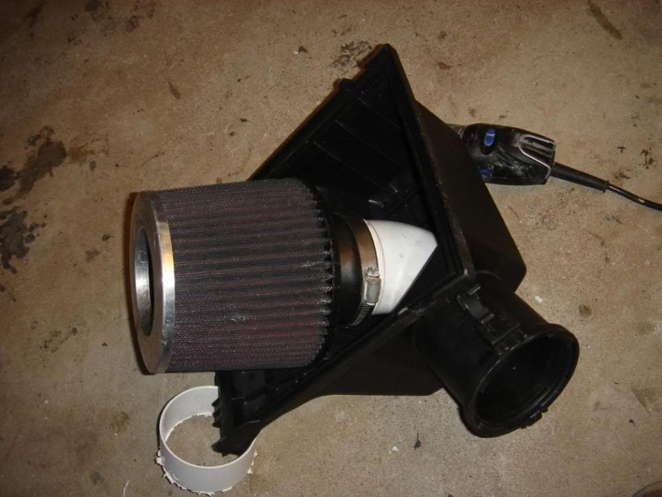

    So I bought a 3inch "L" shaped PVC from bunnings pressure fitted into OEM swiss cheesed air box and silconed it on.
    Than this is what I got.
    So now everything is bolted on
    Verdict:
    Well... actually give me time. I am going to add a full tank tomorrow, result will be out ~ a week.
    But performancewise I feel less torque but more power if that make sense to anyone. Not exactly sure if my mind is playing tricks on me or what not, I honestly did feel more power especially after 3000 RPM.
    However, one trade off is the induction noise. The sweet soundofav6 sounded muffed, it produced a lower pitched rumble during hard acceleration after the mod. Think of the induction noise after the mod as an idling V8 during heavy acceleration however with only the pod, the induction noise sounded lot more beastly and more aggressive but less "power".
    In essence, this experiment is attempting reveal if a heat shielded pod will give better fuel consumption than a non heat shielded pod. So subscribe to this thread. Fuel consumption result would be out in about a weeks time.
    So you've basically made a way for a pod to fit inside a stock airbox, correct?
    Interesting...
      Yeah basically... it fitted flush into the box

          Still if flow is good and the stock airbox should hopefully act as a semi-decent heat shield. Looking forward to seeing the results of your experiment.

                    Just my 2 cents: the design of the airbox is partly influenced by the movement of air going towards and through the AFM in the intake pipe. Basically it'll be most efficient this way, in terms of being able to meter the correct volume of air for the combustion process. Air will be channeled so that it will travel with as little collision as possible.
                    From what I know and can see, using a pod filter distorts this, but apparent change in performance/response/induction noise is due to a less restrictive system.
                    What you're doing may help in reducing intake air temperature, but will be more restrictive (reduced induction noise in your case?) and might still not be any more efficient than an open pod... my thoughts anyway! I'm not exactly sure that I'm correct with what I just written down though.

                        Yes quite, I suggest you examine various types of heat shielding strategies and technologies to find out whats best, another trip to bunnings might be in order. I did a 3 sides enclosed metal airbox in mine, but the pot is pointing straight and down a bit.

                          Now I know why people would say panel filler would be the way to go and accept the priced of the High end air filter that comes in a box eg BMC CDA. because it gives the best of both worlds, ie heat shielding VS performance possibly fuel consumption too.
                            Would that work the same for the cold air intake 'mods' as well? The thing where people put a pod on the end of a heat-resistant pipe, and the pipe leads to somewhere down in the lower bumper so the pod can suck in purely cold air
