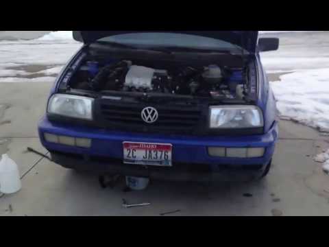

                Which is installed near the bottom of the engine block close to the water pump and can be replaced just like this:
                Now please note that the video is for a US Jetta Mk3, so there are probably some slight difference between the US-spec 2.0l and yours but the general principles are the same.
                I need to do the same repair on my CL but have been holding off until I can afford to get my mechanic to do replace the timing belt, water pump, thermostat and coolant temp sensor all at the same time as I am lacking the time, garage space and tools to be able to do this without alot of swearing, cursing and throwing of tools and stuff.
